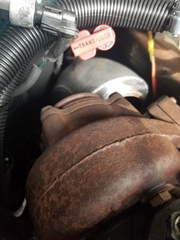

Ok so I read it in your thread! Yeah, that's the part number I got from diamond eye. It was for a 89 to 93 cummins, 2wd, 4" downpipe. I could not get it to align. I had to cut the 90 degree turbo elbow or start of the downpipe off, just to bolt it to the turbo. But it was wedged into the firewall. Melted some of the plastic factory firewall protection matte. The attached picture shows how it wouldn't line up. I tried bringing it over to bolt up, but it would hit the starter & not allow more movement.
As for the downpipe being wrapped, I'm skeptical. When I purchased my long tube headers for my corvette, they were wrapped from the previous owner. Doing research, I heard wraps should only be used on race only kinda vehicles as the wrap can cause damage if it gets wet. For this reason, I went & had the headers ceramic coated. I was thinking of having the downpipe ceramic coated as well. Thoughts?

Header wrap must be used over 1.7k+ degree ceramic paint to prevent rusting.

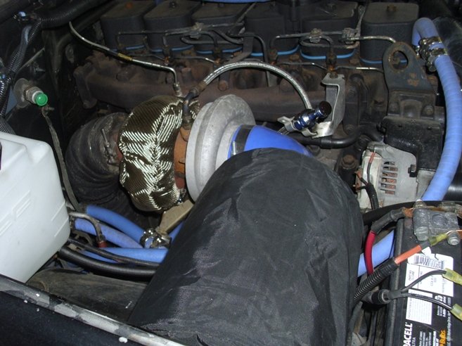

The Cummins can be canted for down-pipe clearance however; judging from the image you posted it looks to be installed further back than my install too.

The header wrap on my down-pipe actually touches the firewall because its triple wrapped and the is no difference in temps where it touches and or on the rest of the firewall.5636056360
