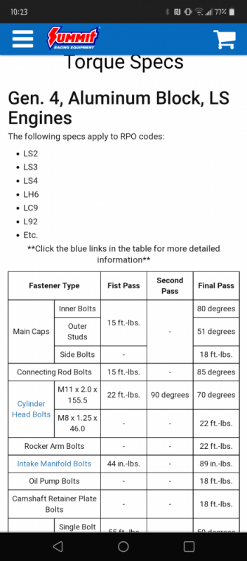

Hey fellas I need a little bit of info I have a 2010 Tahoe it has the LC9 5.3 L Aluminum block aluminum heads I'm trying to find out if this image that I got from Summit Racing is the correct one for the torque specs on these heads and it seems to be the same as the cast iron block and I I think that is a bit much for an aluminum block or is that correctScreenshot_20211207-102320.png
Best to measure the diameter of the bolts that was removed from the engine to get the proper spec.
A caliper that measures both metric and US Standard isnt too much money and about every parts store in the country has at least one in their parts bin.
Once You have one of those calipers You’ll wonder how You survived all these years without it.
This is the simple caliper, no dials or fancy stuff. Just a scale on the side to read the increments. Maybe about 15 or 20 bucks.
