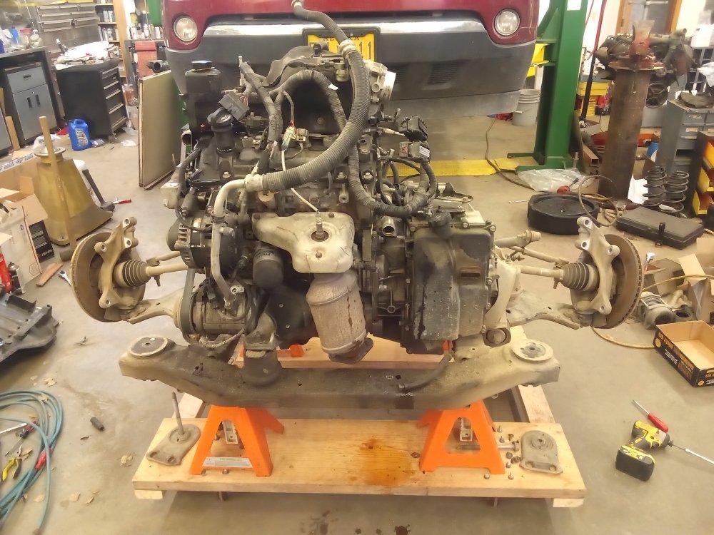

So I took it out for a spin today to try and seat the rings in. All I can say is holy crap. Says it has 280 hp feels like more than that. When I first started getting on it the traction control light was on, I'm assuming from the previous engine issues. Without the AWD and on semi slick roads you had to be pretty careful because it would break loose pretty easy. Somewhere along the way the computer decided to give back the AWD and it was pretty impressive. You could go WOT and feel all 4 corners on the verge of slipping. The engine doesn't really have a redline but it does have a gray area starting at about 6500 that gets progressively more gray. It will easily go 7000 without missing a beat. Anyway I drove it up to the foothills near us and my intent was to make several passes on the 9% grade area to try and load the engine, I did make one run. I started at 20mph and tried to give it as much throttle as I could without it downshifting like crazy. I still hit 75 in less than a 1/4 mile. I decided to go home because I was worried about the cv axles which were making noise.

Wow! that sounds awesome. does it have a trailer hitch? I was thinking maybe if it did, you counld hook up a light weight trailer just to help load the engine. leave it in a lower gear and start climbing. just not something too heavy as to over work the tranny.
