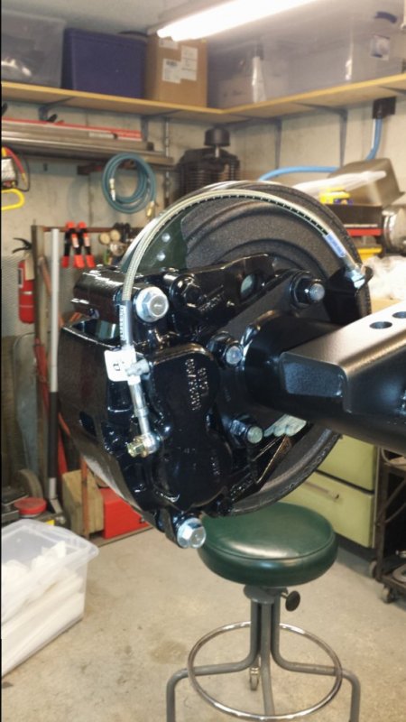

Here's a pic of a rear caliper. Besides cleaning, blasting, & powder coating stuff to look nice, I swapped in hex bolts for the OEM torx bolts that can be plenty difficult if lots of corrosion - if fastener is corroded, you can still get a good grip on hex bolt with vice-grips, etc066.jpg . The brake hose routing is nice in that it allows the caliper to swing up without excess twisting/kinking. On the edge, you can see the aftermarket spring perch welded on at the GMT400 spring pack's width.

Geez all your stuff looks so nice.
Are you talking about the two bolts holding the caliper on or the 4 smaller bolts. I found 3 of the 4 bolts holding the caliper brackets on, so I have to find or order another.
That braided stainless brake hose looks like what I have on my GMT-400, so I'm hopeful they will work.
The 2 bolts that hold the caliper to caliper bracket. You can pull the lower bolt & pivot the caliper out away to swap pads.
The rear brake lines after the ends of the hose in the picture convert to a metal lines going to near center of diff, then T's into one & converts to hose up to chassis, to allow for rear end suspension up/down.
