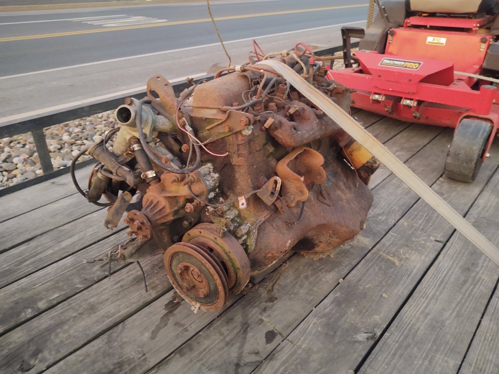

Here is a 660 6.2 I picked up Wed. Ugly as it is, it's loose.

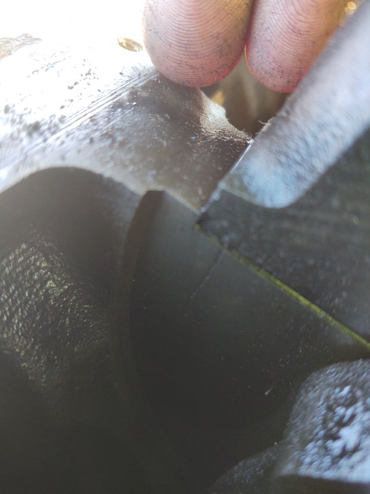

So much for this block.
6.2 n/a
It's actually worse than my 6.5 block.
6.2 n/a
Dang. How are the heads? Them big valves make nice if not cracked.
Most of the take out 6.5 hmmwv engines have good blocks but cracked heads.
Maybe search that avenue if Marty’s doesn’t work out.
