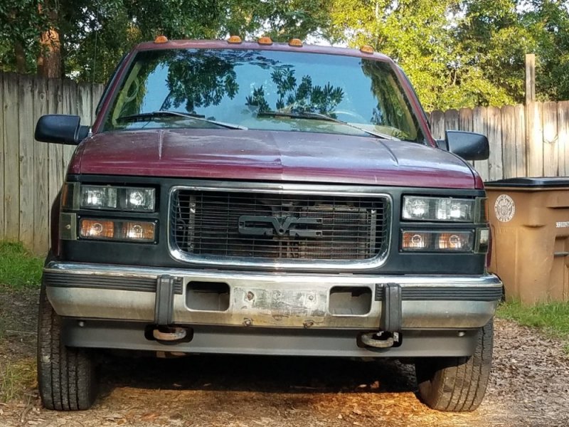

The original grill, head lights and signals were all damaged or not working, so replaced it all with aftermarket, just need to be creative with the missing emblem, on the middle of the grill, thought about some sort of symbol. Bow Tie is just too pricey on eBay for me right now with so many other things to correct first. For now it stay generic.1995 K2500 Silverado Front view.jpg
