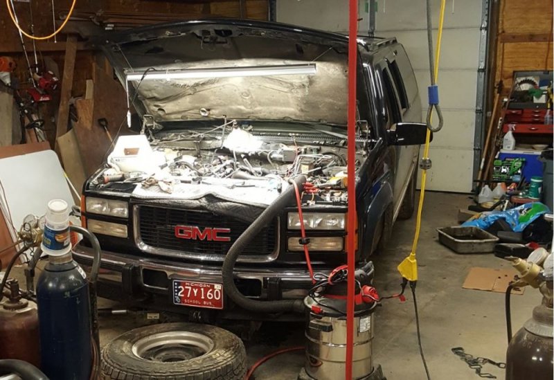

I have the old one out,, the new one bolted up to engine, Now I have to parts run for a coolant temp sensor, that crumbled apart when i unpluged it. and new fuel lines to put under the manifold for FFS to IP. Since I unbolted the coolant covers on the back side of the heads on dr side. So I'll get 4 new cross over gaskets and get this fixed up before going further.
15mm gear wrench is an awesome tool,,, just sayin. 12 point 15mm nut's on IP. With shroud and fan off,, I didn't really have a big issue getting the 3 bolt's off front of IP, I did have a magnet handy. Here's to hoping for a smooth install and a quick start up. It was running great when i pulled it in the shop.

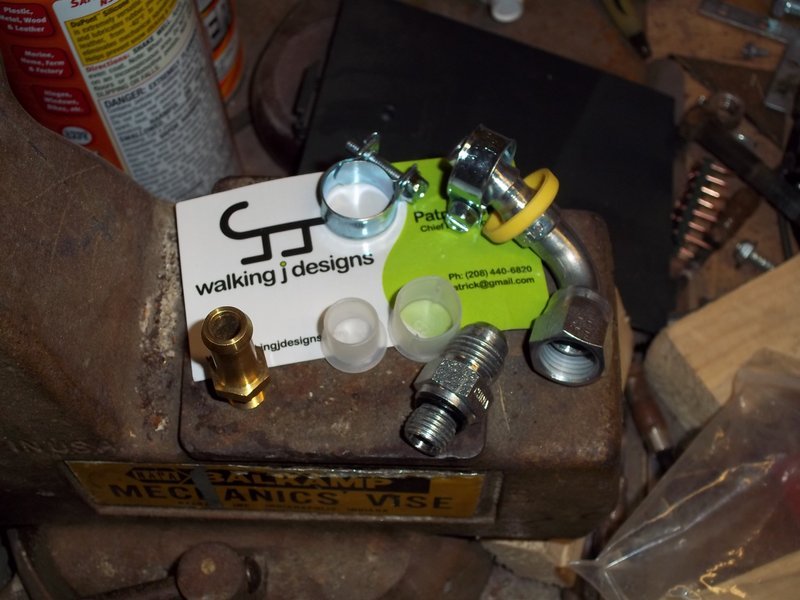

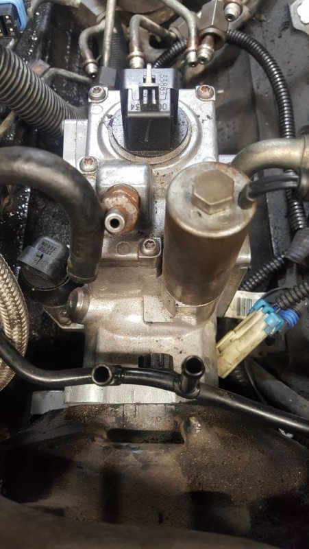

See The fitting with the O-ring? That goes in the top of the IP. then the angled fitting goes on top, and The new 3/8 fuel line goes to it.
As I was purging system with air, via jumping the fuel relay under hood. I opened the fuel filter first,,, then the drain valve,, then I thought I should open that curved tube at the ip to get air out, and make sure I had fuel. SNAP, Broke that darn fitting!!!!
Does anyone know what size to call that thing? or where to get one?
Sadly I put the stock piece in, and hooked up fuel line to it,, to get it running.

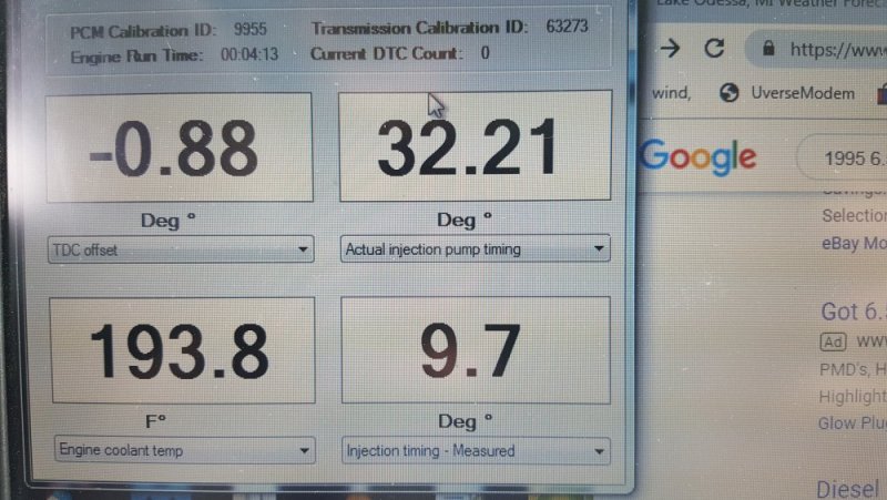

Finally got the Scan tool hooked up. I tried several times to get the TDC offset learn process to work, to no avail. I had 1 code but cleared that, and confirmed no codes. Tried it 3 times before this screen shot, then once after.
Nada.
Any ideas?
57602
would this current timing,, be far enough out of range that it can't do a re-learn and I need to retard the IP to get closer to the optimal window?
Also watched my cranking rpm it was barely over 100.
yeah,, now worried about that starter,, it's only a 4 yr old Napa New unit,, but still starts with water on IP.
I tried the acc pedal to the floor for 45seconds+, with key on,,, then minute with key off, the restart. Timing in scan tool, never changes. Truck does nothing to indicate that a relearn was achieved.
Did you do the time set procedure first? You need to do that and set the timing to 3.5* before you do the TDCO relearn. Gm says you don't have to do the TDCO relearn if only the pump was replaced. Many people disagree and say you should learn it.

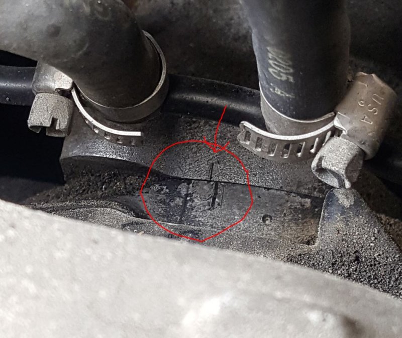

look above. The timing marks are almost perfectly lined back up. 200k on engine, so I'm sure it's off some from Tchain. I have GMTD basic,, It shows what I have now. or what the ECM is thinking anyway.
That don't mean its timed correctly. You MUST use a scan tool to time a DS4. You activate Time Set with the scanner. Desired timing goes to 0 and then you adjust the pump till actual timing is 3.5*. After that you do the TDCO relearn. If your not doing that then your timing is definitely off.
