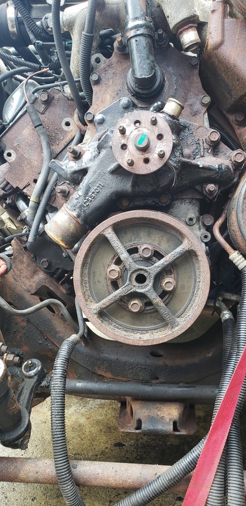

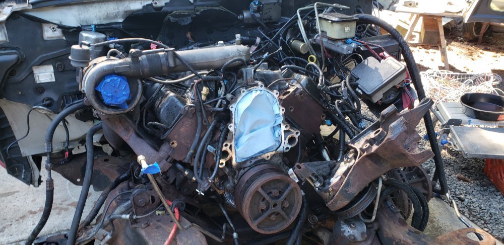

I ended up removing the front clip to get to my engine ground on the rear of the engine LOL. Actually, I'm replacing the rusted inner structure components, updating the cooling system, and incapsulating and painting the frame rails and engine components.

Not sure what year yous is, but from the look of the water pump. go with the 2000 year model 6.5 water pump. use GM or AC Delco only brand. also get you the Duramax fan blade and the electro-Viscous can clutch upgrade from a 2010 express van. it's all a bolt on upgrade. you'll need a hayden fan controller and pigtail to connect the fan clutch. but this upgrade works wonders thanks to @ak diesel driver for sharing the info and doing all the homework for us.
Aaand, before putting it all back together, before installing that very nice Duramax fan system and the Hayden fan controller, get a set of Energy Suspension replacement engine mounts. Your engine mounts are most likely sagged and that Duramax fan will rub hard on the lower fan shroud.
Replace those mounts now before putting back on the front clip. You will like that You did that instead of waiting until it is all back together. Some of those bolts and nuts is mighty tough to get to, at least on the K models of trucks. Also have a 15 mm ratcheting box end wrench on hand too. Turns out that is a mighty handy tool for doing these enjun mounts.
Leroy Diesel sells the Energy Suspension enjun mounts and they are priced right.

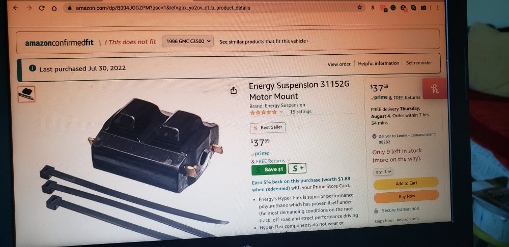

Eureka! It took some time to track down but then I've got more time than money. After checking other sellers' websites which require about $20 for shipping + tax ( the sales tax in my county in Washington State is 8.7% but other counties are almost 10%!) I found the Energy Suspension 6.2-6.5 motor mount inserts on Amazon for $37.69 + Tax but FREE SHIPPING! Now you will see in the primitive screenshot that I've uploaded that it states in red "THIS DOES NOT FIT 1996 GMC C3500".
But the photo looks exactly like the same Mount that is pictured on other sellers' sites. being that there's no problem returning stuff I took a chance and ordered 2 of those puppies
