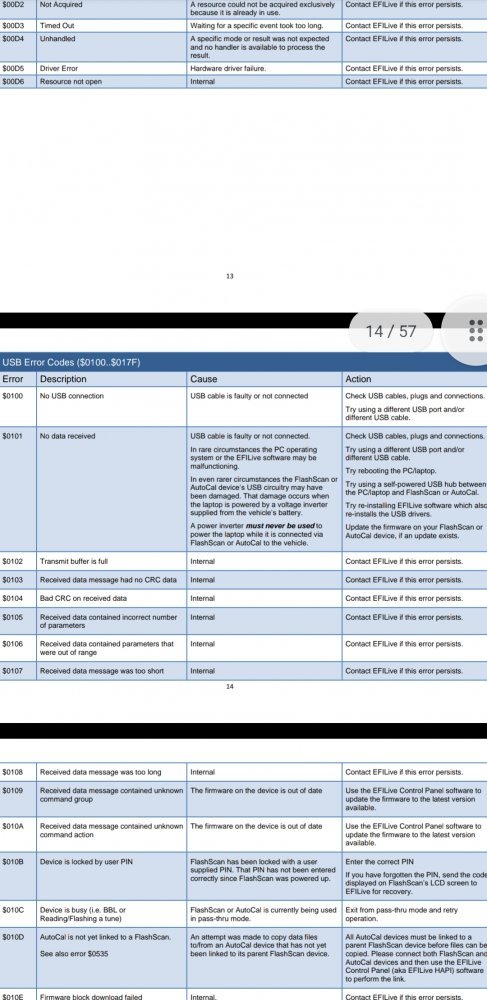

i saw this list of codes and so I run a usb test and it comes back OK and all green check ✅. All my firmware and software is up to date.

My main OS was erased after my initial try of using the flashscan v3 as a pass-through device with my laptop. I just kept getting the &0101 error. I read a few things about usb 3.0 ports not working with efi live so I tried a non USB 3.0 port on the same laptop but I still got the error. Then I tried using V8 explorer to copy the tune directly to the flashscan and i was still getting the error so i knew it had something to do with my usb ports.
I was able to copy the stock tune directly to the flashscan using my desktop without any problem. When I tried to flash straight from the flashscan to the truck I got error $0502. I figured out that it was trying to flash my TCM because the ECM OS had been erased.
I pulled out an old laptop built in 2011 with windows 7 and fired it up. I downloaded the V8 software and tested the usb connections by copying a few tunes straight to the flashscan and it worked without any issues. My laptop battery won't hold a charge so I hooked it up to an extension cord from a house outlet and used the flashscan as a pass-through device with the V8 software on the laptop. I had to manually select the E35A ecm option because the OS was erased. The flash took about 12 minutes and worked perfectly.
Now that my ecm has an OS and is back to normal I could probably load tunes straight from the flashscan, but I like the added visuals of the efi live software. A new battery for my old laptop is $20 so I will just go that route and have it as my dedicated efi live computer.
