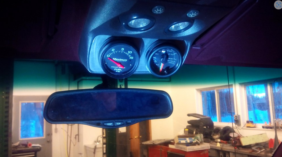

I will need to do something once I get the temp gauge installed. I have heard some folks use the center overhead console area where a info digital whatchamacallit would be right above the rear view mirror. I think it's just large enough to fit two gauges in there.

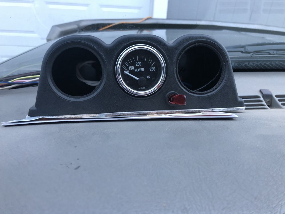

I have a 3 gauge mount similar to the one in here.
Shaped a chunk a old aluminum sign to match the base and mounted the gauge pod to that. It just sets there atop of the left side of the dashboard. Dont even move around up there. Easy to get a peek at too.
When I run wires for the RR head temperature sender, through the far left corner of the dash I also run sending unit wires for the other two positions.
Also made provision for ignition on wires and grounding wires while I was at. Wont have to go through that disgusting problem again. 😹😹😹

The red LED switch is for the electroviscous fan system. I didnt know if having a light that high up would cause me problems in the dark conditions so I used a lighted switch so I can tell when the fan kicks on. Thats its only function, then I can flip the switch and the light goes off.
