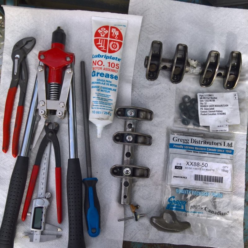

Here's what you need:
  • 1/4" by 1/2" long stainless steel rivets (NOT ALUMINUM!) - available in pack of 50 at Gregg Distributors (PN XX88-50) They are 0.245" in diameter and expand to 0.335" (~40%). The hole they go inside is exactly 1/4".
  • Extra thick Black Iron M6 washer - Available at Fastenall (PN 11128411) - Sold per.

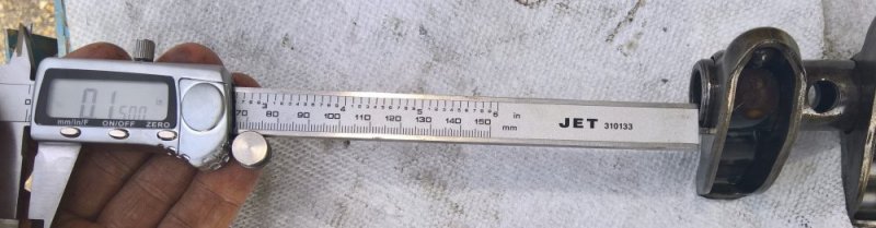

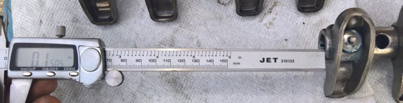

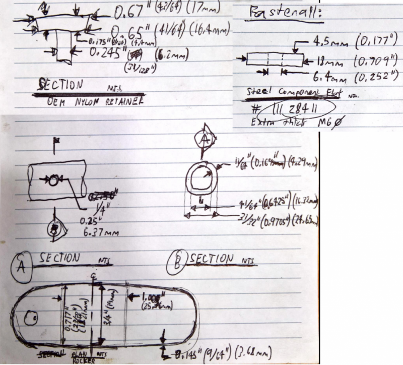

I measured everything and you get the same lateral movement of the rocker as stock with the above parts (±0.005"), so it should perform just like stock but waaay less likely to break. The important thing is to not tighten until the rivet pops, just tight enough that the washer can still rotate. You need the washer to rotate so there is minimal rubbing against the rocker. One could drill a 1/4" hole into the old nylon retainer and use that instead of the black iron washers I used, but was worried about the nylon breaking on me again. Others have used brass, but the washers I used are dimensionally the closest to the stock retainer that I could find.
If you fasten the rivet too tight you can use a hammer & chisel lift the washer then tap back on the rivet then the washer should rotate freely. Oh and oil everything up first. I used engine assembly lube.
57719
And for tools:
  • Big-ass rivet gun (these things are built like bolt cutters)
  • Cylinder File or Dremmel tool
  • Pliers
  • HD wire cutters
  • Flat cold chisel
  • Hammer
Step 1 - Disassemble and label your pieces so the rockers go back in the same order & direction.

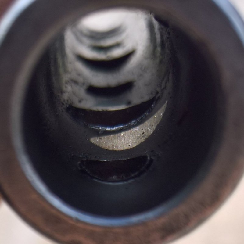

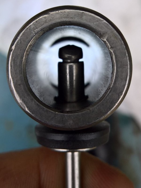

Step 2 - De-burr the inside of the tube where the factory drilled the holes for the retainers, I used a file for a bit then got a dremel tool, that tube is hard AF. I cleaned out the shavings like a gun barrel then rinsed it.

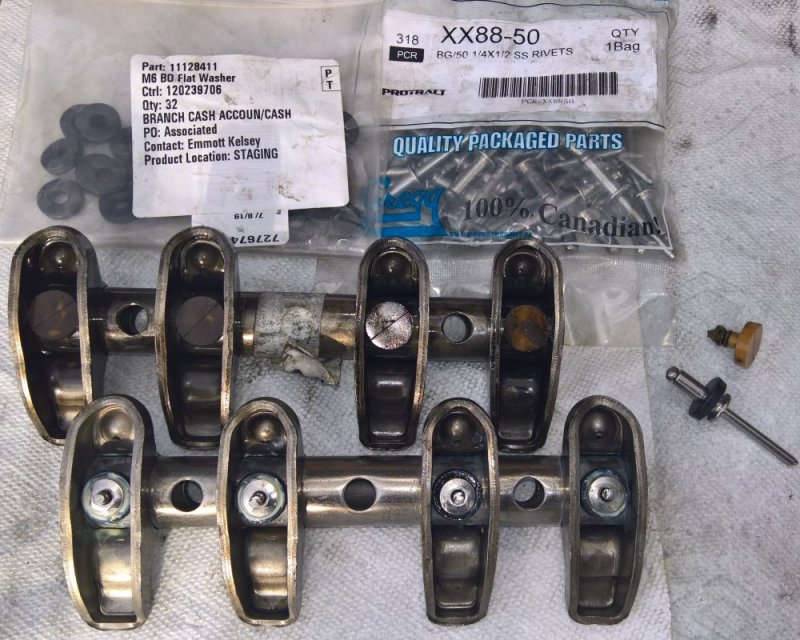

Step 3 - Slide on the rocker and lube up

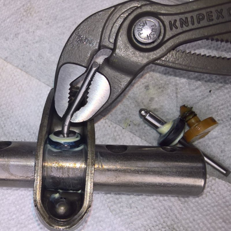

Step 4 - Insert pop rivet and washer. The washers are concave (shaped like a crescent moon) I shaped the arch down so it would rotate easier. Note that the thick washers also have a slight taper, to match with the taper direction of the stock rivet you would have to face it the other way from how I did it. Your call. Remember to put the rocker in before the retainer!
Step 5 - Fasten! But don't pop the rivet! Go until you see the expansion of the rivet just about touching the inner wall of the cylinder. Double check you can rotate the washer on the other side. When it starts to feel snug you're done.
Step 6 - go grab a beer.

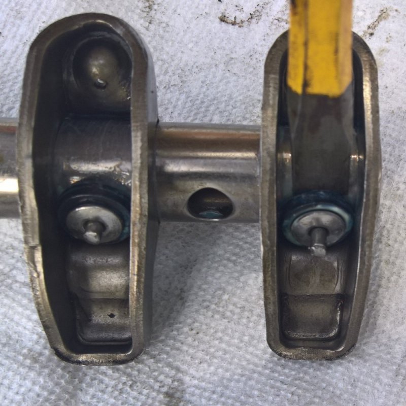

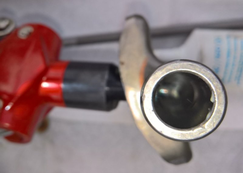

Step 7 - You were an idiot and you over pulled on the rivet and now the washer won't rotate. That's ok! Just use a cold chisel & hammer to wedge the nut up a bit, tap down on the rivet, then the washer should be freed up.
Step 8 - Cut off the excess rivet stem. I used an HD wire cutter to notch/weaken an area the stem close to the washer then pliers to bend/break it off. File the end if you don't like sharp edges, but file upside down so the shavings don't fall into the rocker.
Rinse and repeat.
I checked to see if the stem left inside the rivet would fall out by hammering on the top, it didn't budge so it's not going anywhere.

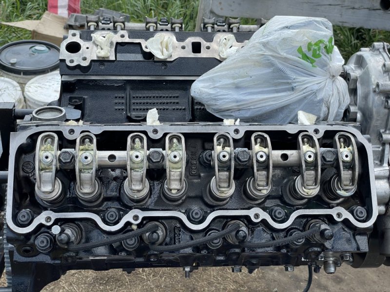

Here’s a pic of the final product:
