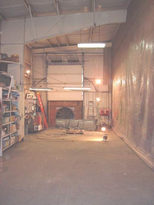

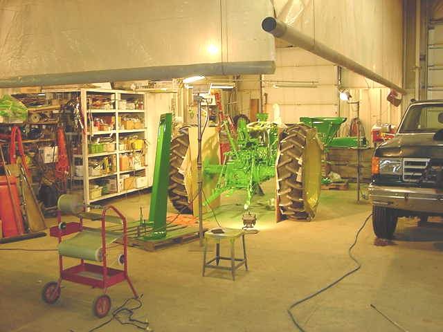

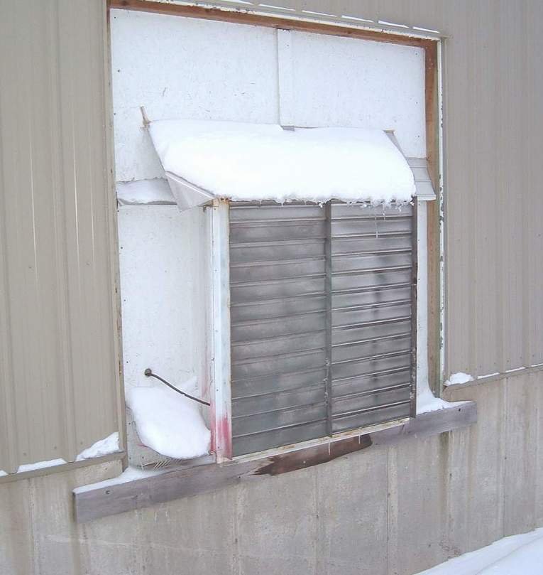

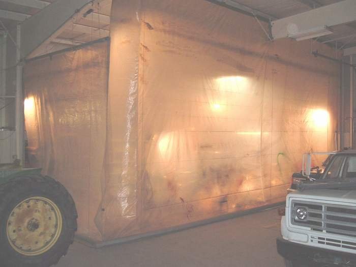

This guy doesnt know squat about a paint booth. He is building a clean room. A booth is negatived pressure, sucks fumes out, a positive pressure is like a balloon, blows it out every crack... There is a fundamental principle in ventilation and he missed it in class that day. Sucks fumes out ofpaint booth half way 2.JPGpaint booth end 2.JPGpaint fan outside.JPGpaint booth lit.JPG building NOT blowing them everywhere.
