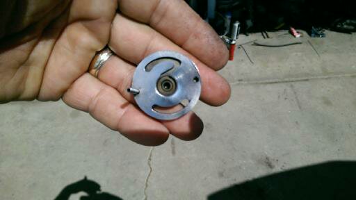

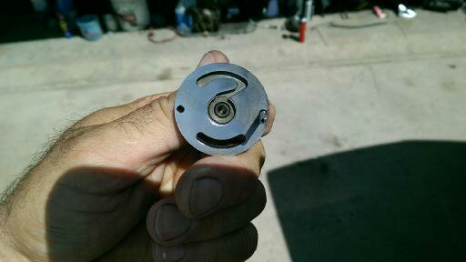

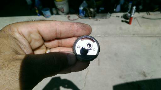

Good News! FUT lives! That was a steep learning curve, so let me pass on what I learned the hard way. First off the Ford DB2 input cone does fit and it doesn't need to be drilled and taped. The ford regulator assembly is not the same and will not work on the GM DB2. Second be careful with the roll pin in the regulator assembly. If you get a bit aggressive while cleaning it, the pin may dislodge. Third be aware of the location of the pin as there are two possible locations it can go into. There are markings on the non machined side of the regulator. One is marked "C" and the other is marked "CC". These indicate clockwise rotation and counterclockwise rotation. Due to some very bad fuel contamination I ended up getting a DB2 from the local wrench a part. After installing the new to FUT IP, it still wouldn't start. I found the Stanadyne operation and instruction manual for the DB2 and within I found the explanation of the pin locations. After reading this I pulled the cone back out and switched the pin location. After reinstalling the cone and closing everything up and cranking a bit, it started.

By the way mine likes the "CC" position. There is also supposed to be a way of decoding the data tag on the pump itself. I have a copy of the Stanadyne manual if anyone wants a copy let me know. I would put it up here but it's kinda big and I don't want to get scolded and sent to bed without dinner. I hope this helps somebody out there. I almost forgot the best part. The FUT runs great now. With Leroy's Walbro pump and the FTB complete and 1/2 turn on the pump this thing runs great. I also had to replace the starter in all this mess. I love this Powermaster starter! Now I too can say "My starter has more torque then your Honda. LOL
