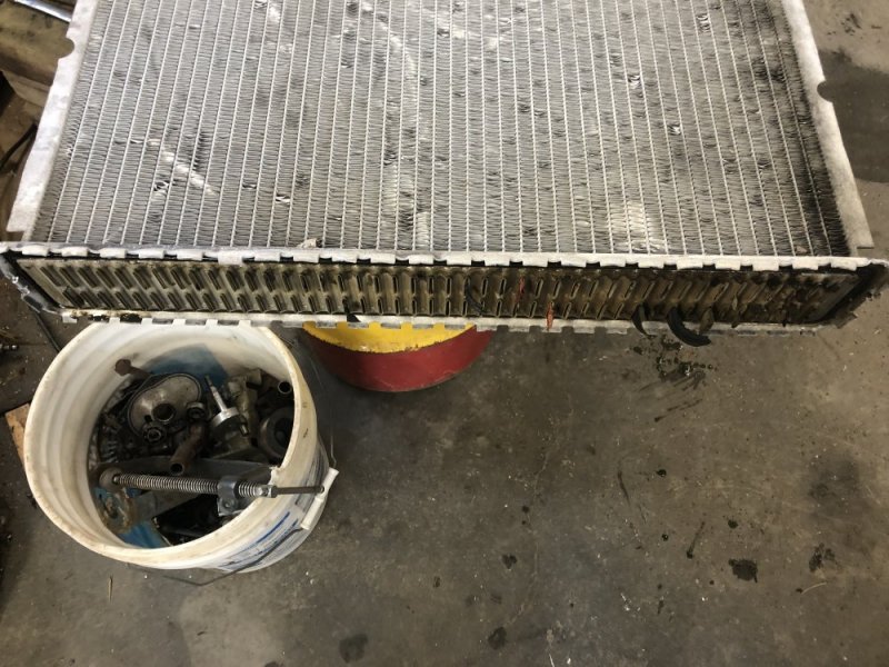

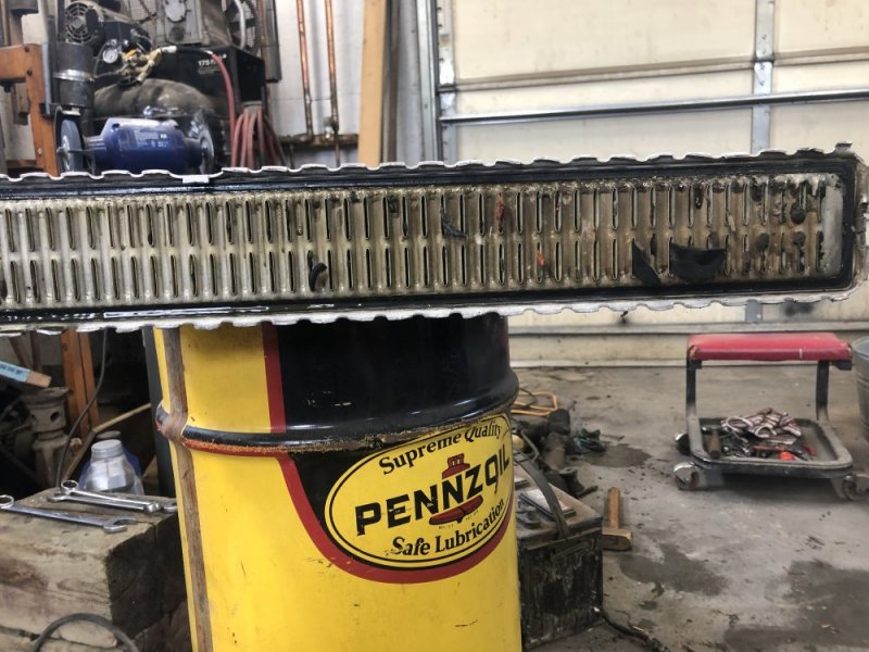

I went and deleted the pics of the old radiator I had removed from My truck. I had removed the tanks from both ends so I woulnt get docked at the recycler for having them plastic tanks on there.
The cross flow tubes on the inlet side had a lot of crap stuck in the tubes.
If I was going to do a filter on My truck, it would be someplace between the thermostat housing and the radiator. Then it would catch any impurities or chunks of rubber from the thermostats or any kind of silicone sealers that some PO may have used and over abundance of.
I’ll see if I can find the pics and post them in here. I think I threw them out in the what have You done with Your GM400 today, or some such. 🤷‍♂️😹
Expand the pics to get a real good look at the cross flow tubes.
Those thin black shaped pieces of rubber is from the old factory style thermostats that had that black rubber housing around them.
I have never used red or black silicone sealer on this engine. That was all from one of the POs.
