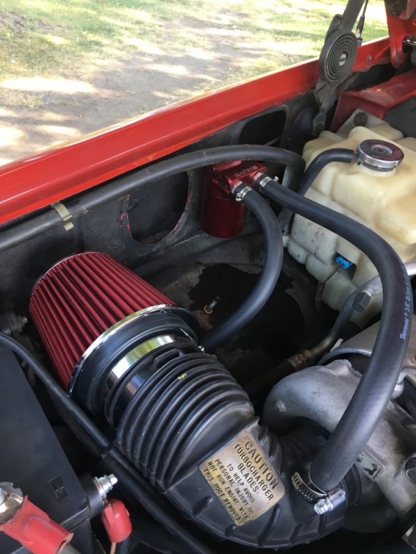

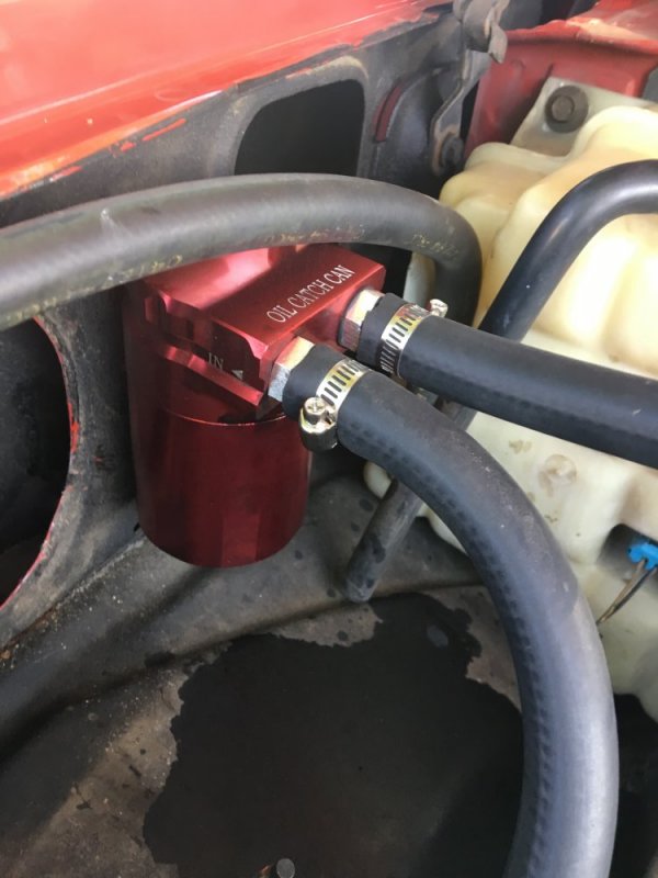

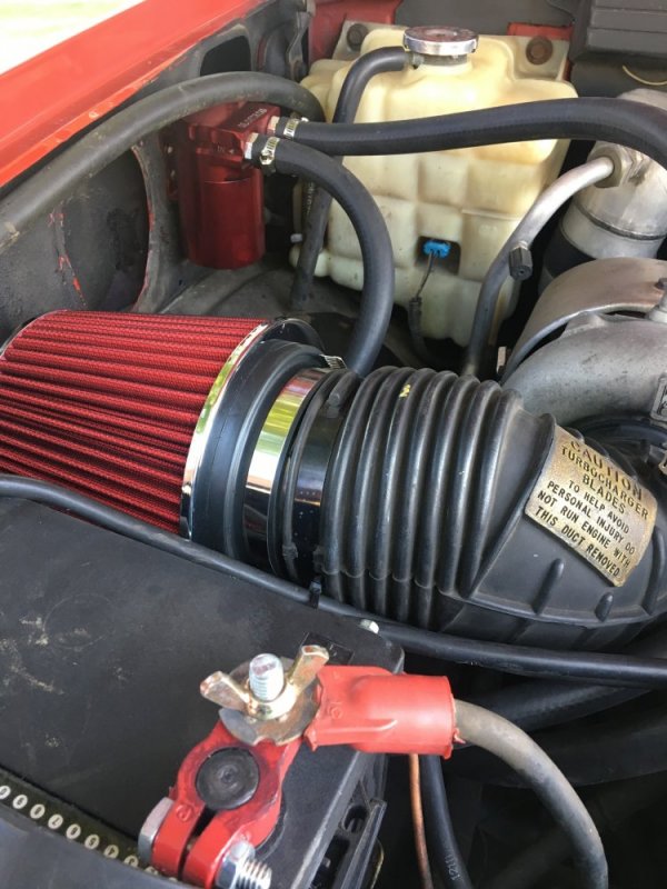

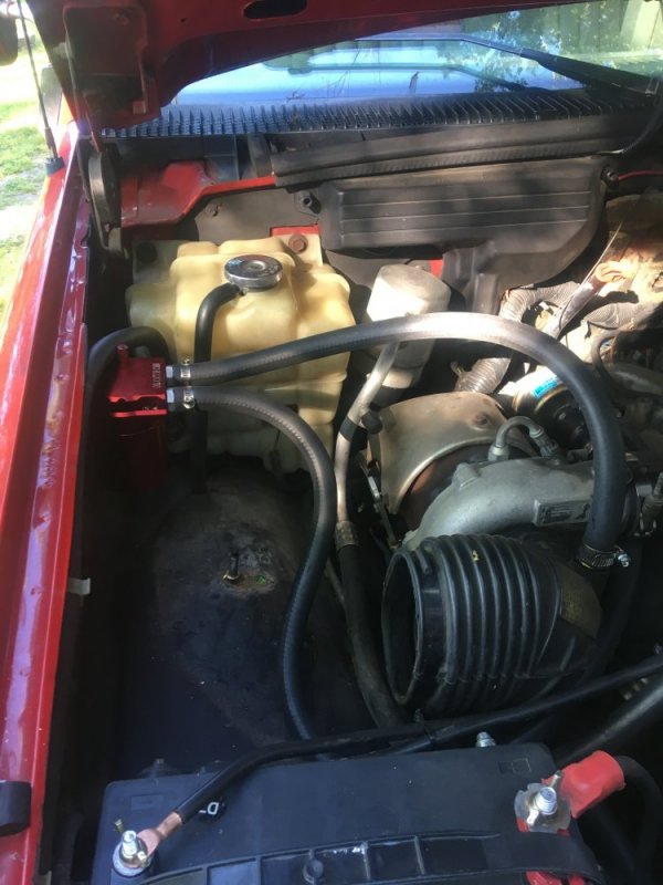

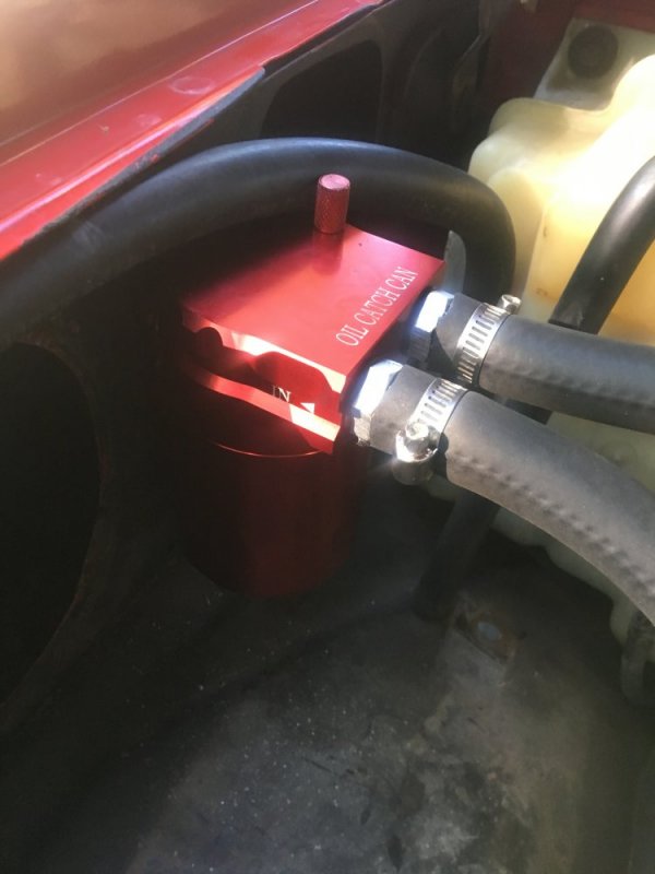

Just wanted to share my little project with you guys because my wife didn’t seem to share my enjoyment of it Seems to be working as planned, the truck feels a bit better according to the butt Dyno, and the catch can is retaining oil. The hose between the can and intake is basically dry, which makes me feel better. The whole thing only cost about 75$ or so and I feel pretty good about it, time will tell if mpg is affected in any appreciable amount. The change in performance and cleaner air intake was worth the small cost, and the turbo sounds pretty cool too have a good one, Matt

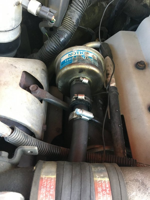

Thanks, I kept it because I was under the impression that it acts as a regulator valve to keep pressure at the correct level. If I’m wrong about that please enlighten me and maybe I’ll change it up. Always ready to learn something new.
8,660
Likes
8,453
CDR=crankcase depressurization regulator-
In other words it limits the amount of vacuum to the crankcase.
As the rpm increases the amount of vacuum will increase on the hose that is pulling out crankcase fumes. With a stock system without a CDR it would be sucking too much oil fumes to that in engines intake manifold and cylinders.
The engine oil will work as a fuel, accelerating output of control known as runaway once blowby is an issue. YouTube search “diesel runaway” and you’ll have a panic moment. So the CDR lowers the amount of vacuum going into crankcase as to not burn off this oil as easily.
Using a catch can that stops all the oil from reaching the intake, you can run at full “vacuum” that it will produce.
Running the crankcase in a decent vacuum (8-10” is safe goal for stock engine) to the catch can will increase power. The vacuum is one of the great advantages of a dry sump system. While most power increases are seen 8-16” of vacuum, at around 15hp and 10# torque, this level tends to increase oil flow and 5-7 psi drop pressure. While that sounds scary, more oil flow is a desired item, provided enough oil gets to all components. For us with the vacuum it creates we will not see those power gains or effects. We tend to get 3-4# and 4-5hp with 1psi oil pressure drop WITH THE MOST effective catch can and at high rpm because we simply don’t pull that much vacuum. Most catch can systems will not pull the vacuum required to see any power gains, so it is a cost savings venture only.
The draw back is needing to drain the catch can back into the pan either periodically manually or a drain line that does not allow the vacuum to pull the oil fumes (only liquid) back to the pan.
Also If you have a proper working catch can, there is no function for the CDR, saving the cost of their replacement. Simply shelve the one you have incase you decide to go back to it instead of the catch can. idk anyone that ever has, but...

Ok, so I did understand it correctly in concept then, but didn’t realize that pulling more vacuum would never be an issue. I’d like to remove it and have less connections if possible so thanks for the input.

The CDR was an emissions device for the manufacturer with the side benefit of making seals last much longer. So if you do remove it expect the seals on the crankcase to start weeping a little.
My understanding is you'll only see any real gains in high rpm engines. FWIW our engines don't see anywhere close to the amount of vacuum Will is talking about, I had to use a digital manometer to even read it. Wouldn't even register on a water column.
CDRs very seldom fail and can be cleaned, I tested every chemical in my shop to see if it would affect the diaphram in it and nothing would hurt it. Just be careful to not get anything in it thru the pin hole in the back side as I would imagine liquid sitting against the diaphram would affect it's operation.
