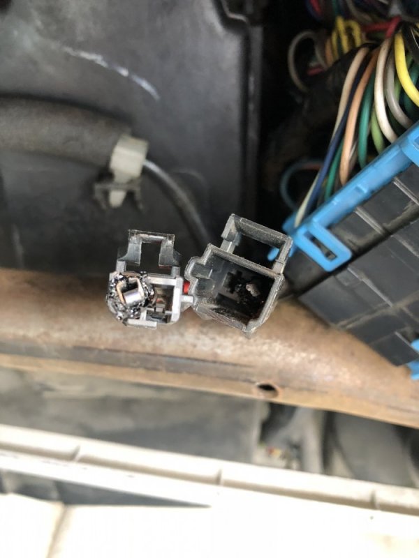

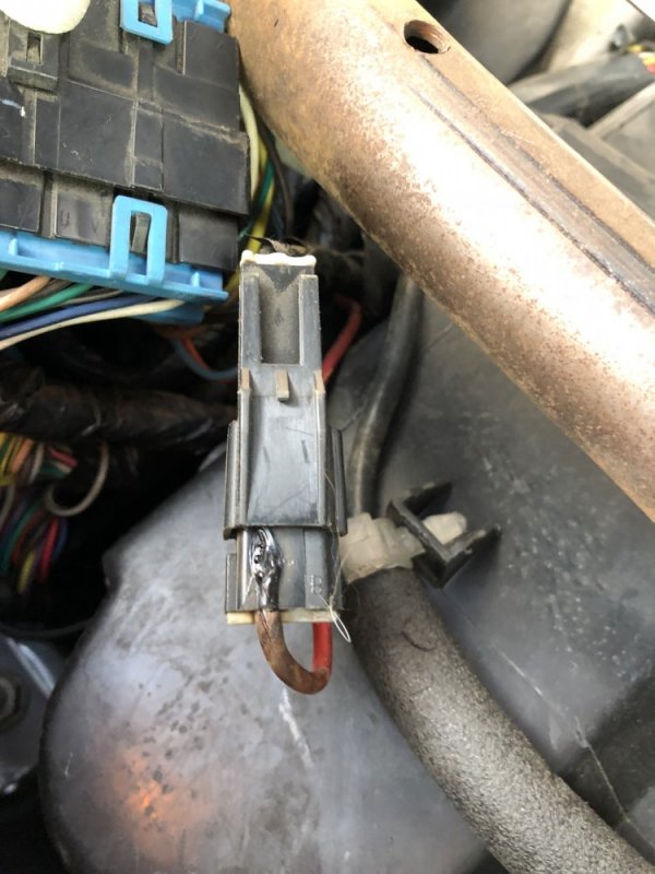

I went out and put the amp meter on it. It pulls 19.6 on the uA setting. After about 30 seconds, it starts to get hot and then it loses connectivity and motor goes off. Jiggling the wire gets the motor going again. So it sounds like the plug is bad. What do you do for a replacement?

Blower control module is only on vehicles with auto temperature control. All others got just the resistor.
Having trouble finding a plug replacement.

I would cut the wires back to where they are not burned, crimp, solder, and tape it up. The connector is for the assembly line. You may have to replace the wire if its coroded or melted a long run.

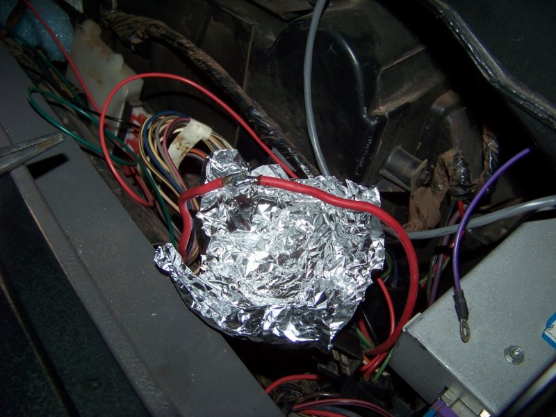

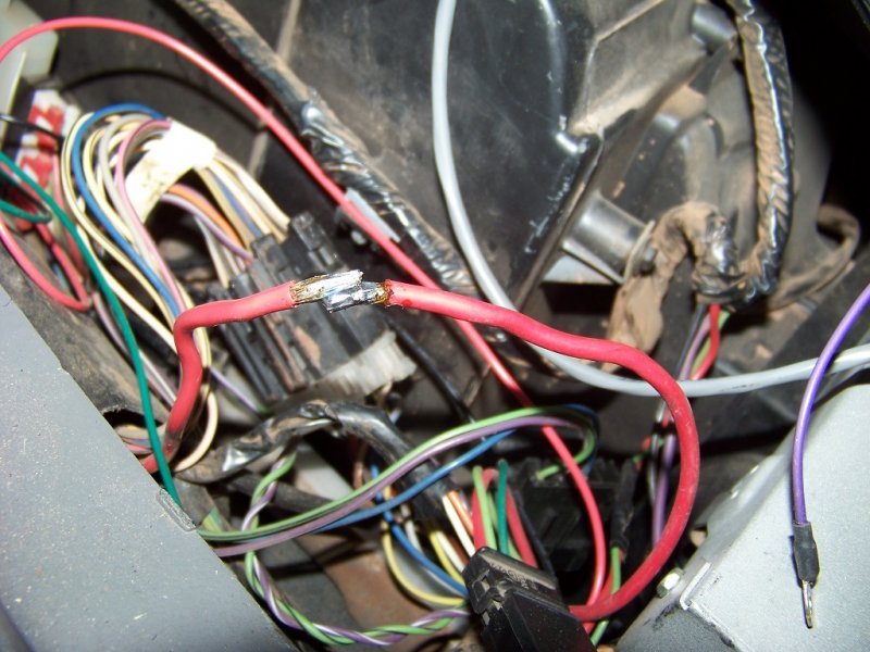

This is the type of wire repair I suggest. No crimp on this one. Aluminum foil catches drips.
