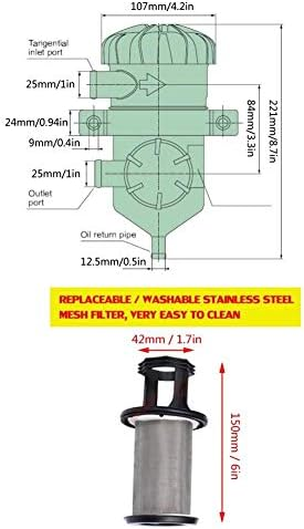

For the blow by loosing oil- get rid of the cdr, install a provent200 in its place. (They make many sizes, the 200 is correct for us)
It is the most effective “catch can” available. You can buy the ebay knock off to save money, but throw away the ebay filter inside and buy the real provent filter. The only bay filter doesn’t work well, but the provent filter fits in the knock off housing.
You could modify the oil pan and make it an auto return but for this engine that is nearing death- I wouldn’t. Just check the can once a week and after a while you will learn when it’s full. Just drain it into a bottle and pour it back in the engine.
Here is how to drain it to pour the oil back in. I suggest adding a thread on cap to the ball valve to keep it clean so you can reuse the oil.

I do want to get that provent 200 for My truck and it has literally no blow by.

Just where he chose to.
You can either make it auto drain or just have it hold the oil (usually a long hose down with a cap) and pour it back in yourself as needed. So placement depends on how you want to address that.
Then to promote less oil even making it into the can, the farther away the can is from the valve cover, the better- so long as you dont create a “p trap” and you have good airflow in your hose system.

You want the highest ‘vacuum’ into the can possible. In racing an actual vacuum generating pump is used, so the hose from intake tube to can should be short. But you are playing engineer so imo make things adjustable when starting out. Once you learn what the best option is- then get rid of the bailing wire holding it and build a bracket
You don’t want it next to the turbo. Heat and plastic not going together with flammable liquid inside is probably a bad combo. Haha.
And DO NOT use the auto drain tied in with the turbo drain. You don’t want the turbo oil drain flow competing for free flow. I suppose someone could fabricate a new cover plate that has two separate tubes that wont interfere with each other somehow- but that sounds like more work to me than an oil pan bushing install.
