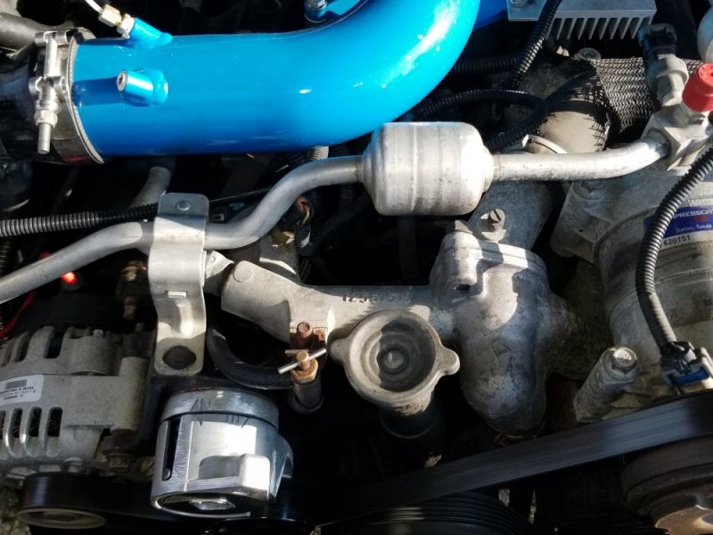

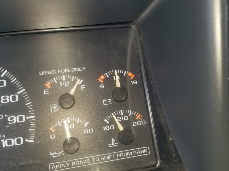

Pulling a bed full of elm temp spiked slightly, maybe 190, after being out of the boost. Gauge usually looks like the attached pic. On another note, is oil pressure normal? This is cruising in od, about 1500 rpm. Also attaching a pic of my coolant crossover.

96 only, had the accessories on the opposite side as 95 and earlier (same as 97+) but only had a single tstat whereas 97+ had the dual stat

FWIW, the picture of the gauge cluster indicates the truck is a 96+. If so, consider getting an Edge monitor as it will provide coolant temperature as the computer sees it (from the sending unit at the crossover) versus the dash gauge which is not really accurate and gets its inputs from a sending unit in the head above #1.

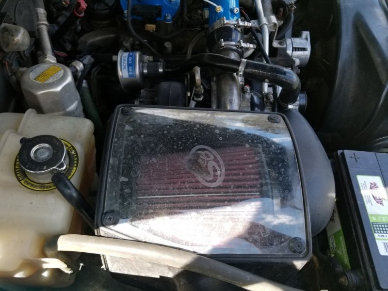

I will look into the edge, thank you. I understand factory gauges are not accurate, just going off what i have to work with. Since the turbo swap temps will intermittently spike hauling light loads, can only imagine what will happen once pulling a loaded trailer and bed full. I am running and s&b cold air intake, which is routed thru the factory "ram air" bumper inlets. The s&b had a silicone plug in the box, opening the box up to engine compartment temp air if the owner wishes. My plug is installed, only sucking thru the "ram air" .
With the '96 cross over, will i have issues converting to the balance flow water pump, as far as cavitation? I want to upgrade to the duramax fan, im sure that will help immensely, but want to avoid double buying clutches, adapting to the 4 bolt then screw on, or vise versa dependant on which water pump will work best.

With your set up you most likely have the low volume water pump. An upgrade would be to use the 97-98 water pump as it has more volume. A better upgrade would be to use the 99+ water pump as it's balanced flow so it flows more equally around the engine. I really like my electro viscous fan clutch as it's activated by water temp so no lag time waiting for the thermal unit to heat up. Plus I have an override switch so I can anticipate the big hill coming up.
