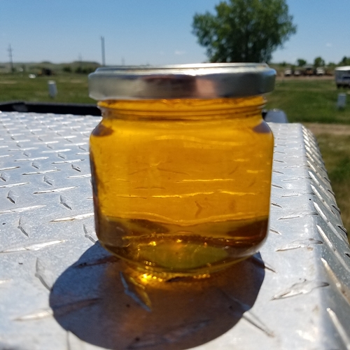

I've talked to quite a few people that apparently tried WVO in the wrong way. They all ended up with stuff plugged up.
I've been running 11% Bio since the 90's sometime when I could first get delivered. Sometimes more sometimes less. But mostly 11%. Sometimes as much as 90%.
What I have personally seen of filtered WVO looked like a dirty fry kitchen. Grease and muck in the lines and things getting plugged up. I never saw anybody actually post up about long term success with a 6.5 and electronic injection
Here's a pic I just took of oil I filtered. I think this was with the paper element system too, so the oil I filter with the centrifuge is even better.

@jrsavoie If you can look at the fuel and tell it is not diesel by sight alone, it is not filtered correctly. See how clear Hink's is? That's mandatory.
