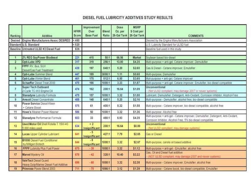

I ran Stanadyne Performance Formula for years and then switched to Opti-Lube XPD, not sure which one is the best the Opti-Lube had some great test results if they were accurate.
I wouldn't mind to get some Power Service and try it since I would not have to order it. I have to order the Opti-Lube like a carton or case at a time to come out cheaper. Do you guys think the Power Service is pretty good, I suppose it would be better than no additives?

I have used Power Service for well past 400k and over 330k on this truck on original pump and injectors still. Is there better? Maybe...I have been tempted to try others but I can't see why I should.

The big problem with a lot of those is they are emulsifiers.
So as long as there is no water present, it is ok. But as soon as any water at all is there- a very humid day and a half tank of fuel- it just soaked in waterand the water even i suspension tears the hell out of ip and injectors.
So all the “good” the lube added, it just did years of wear in a day.
