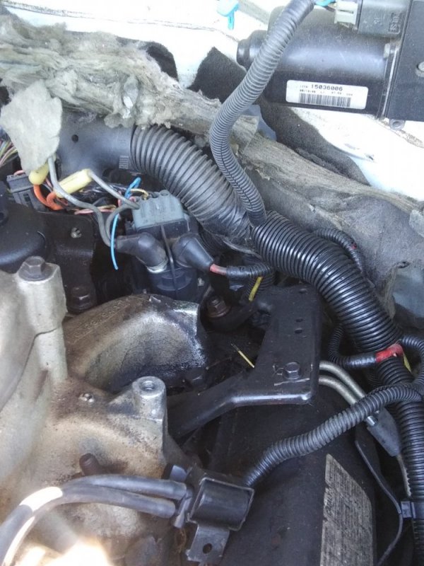

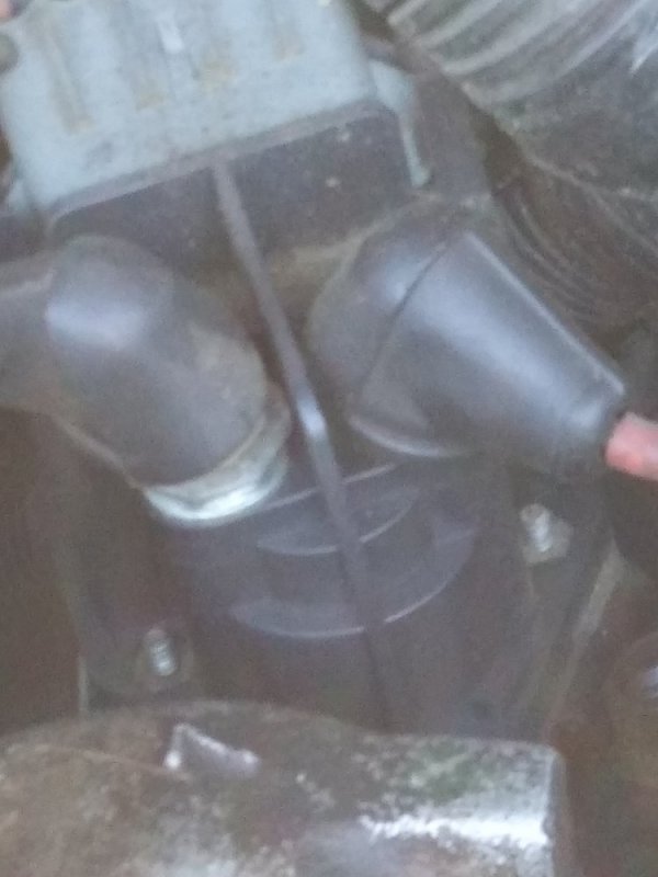

Anyway I put it up at 6pm Sunday. Had first interested buyer come out at 10pm. Thank the Lord I didn't have to work Monday. Anyway we had put new pmd on with no resistor. Rpm's shot way up. Took pmd off and added resistor. Ran like a purring tiger kitten. Until prospective new owner decided to test why it won't reverse. Beast baby screamed and shut off. Being as it was dark out (not many street lights when you live 1/4 mile off the back road in between a couple cattle fields) and me at the front of the truck I noticed sparking when trying to start it back up from a little black canister at the driver side firewall with the app wire (I think) running into it and another wire coming off it (to ecm/main computer?). Anyway guessing that is the culprit to her "surging" and runawayness. And thanks to said buyer who busted the top of my fuel filter I need a new one.
Any ideas? Thinking definitely app and or wiring to it.

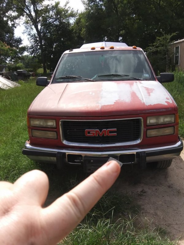

That's a pretty straight body and good dual fenders for age/miles. The dent free tailgate... this wasn't a work truck for sure.

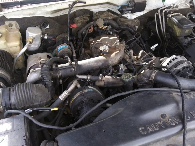

The PMD on the pump, in your picture, is dead? Maybe eliminate the extension cable and see if it runs off the PMD mounted on the pump? Or other PMD just tossed under the hood on the OEM wire harness only. Again always have the PMD on a heatsink or they quickly overheat and fail.
Looks like the air filter needs a service, and although that hot air K&N type setup is not ideal, some of us overlook a dirty clogged up air filter when troubleshooting.
Grounds are one of the first recommendations to look at. Take apart and clean them.
