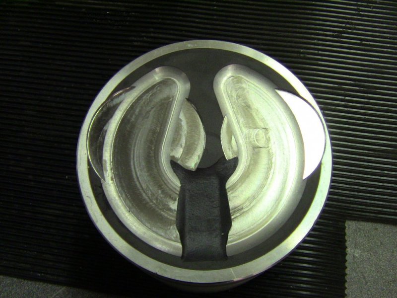

A sneak peak of TSP's 18:1 pistons
I'm you have answered this before but why valve reliefs? Are you making a cam that will need them?
Well if someone want's to go 1.6 or higher ratio rockers, like me for instance, this is one area that would need the clearance, and how many times have we seen someone remove heads and wonder why their is a imprint of valves on the top, carbon build up, slack timing chain, valve float, etc their is very little valve to piston clearance in stock form as it is..
So while I am machining 3 p400 sets that require the clearance, I have 10 new sets to machine to sell, 5 sets will be 18.0:1 with valve clearances, 5 sets 18.5:1 without valve clearances.
Just giving a couple options for those that may be considering different options.
The pockets won't affect anything being their for a basically stock motor, but would be a factor if moving towards other mods...

Just curious are the machining marks being smoothed out or is the coating supposed to take care of that?
You can't feel the marks at all, this one has just been rubbed with scotch bright a little and those disappear. It just the nature of a flat end mill I guess, in person they are glass smooth, once coated you won't see anything..

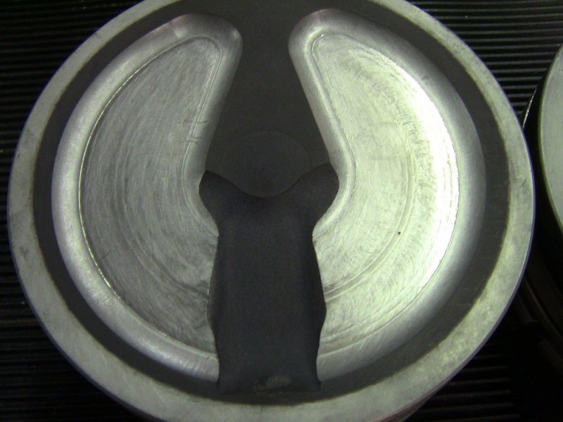

Got them all done today, here are the 18.5 version without pockets.

I like the idea of the valve relief area. The 18 to 1 engine I have always showed marks in the carbon on top of the piston.

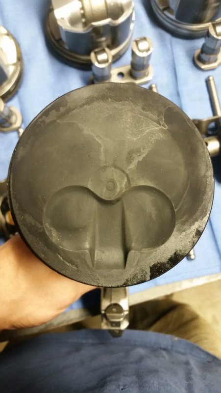

So I'm curious as to the differences in what you're doing to lower compression vs what others have done. The low comp set that I have was built by the Diesel Depot way back in 2003. I'm not sure where they source the pistons but I only had one cracking and it was due to contact with an intake valve. Just a hair line crack, but cracked none the less.
The main reason I ask is because I'm thinking of building another low comp engine for my stepside. The set I have is both use able and balanced. But if there's a better version I'm willing to replace them.
I don't know what DD did, you have a pic?
The old Kennedy pistons cc out @ 17.2:1, I have used them and have a set here.. Mine are a true number per 3 different ratio calculators...
I had a supplier that had these NOS GM OEM pistons, these aren't off shore cheap pistons they are real GM branded pistons.
Most just shave the tops off, this design keeps the quench area of the piston and moves the combustion pressure around the piston during the injection event, I noticed less rattle due to the piston being better loaded during injection..
I've never tore one of these down that didn't have valve strikes on the pistons...
The main reason I did it at all is my P400 is getting 1.7 rockers and needed clearance , so after thinking I decided to run 5 sets that others could consider and have a choice.. If they don't sell I'll use them in customers motors..
This is the .020 over piston that DD used. I know I bought a replacement for the cracked one from pennisular and it matched when I measured it.
Thinking back my low comp engine was fairly quite even with the timing way advanced. The marks were a solid 1/8th inch apart. It was a very cold hearted though, had to sit and build some decent heat before driving.
