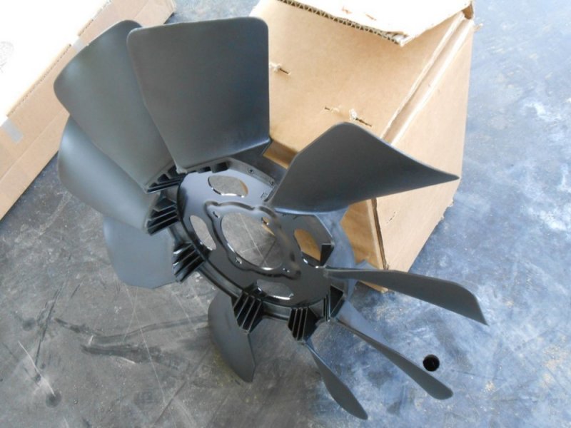

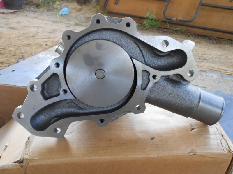

Sort of nudged me into my next round of improvements. The fan clutch crapped out, the water pump was squeaking when rotated by hand and the fan I just HAD to add that Duramax fan.

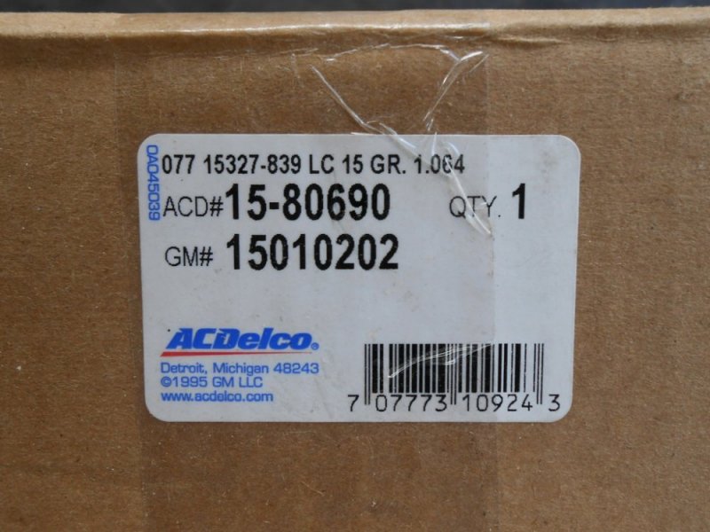

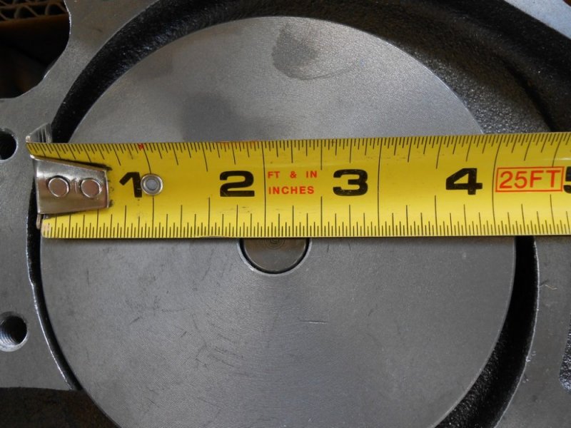

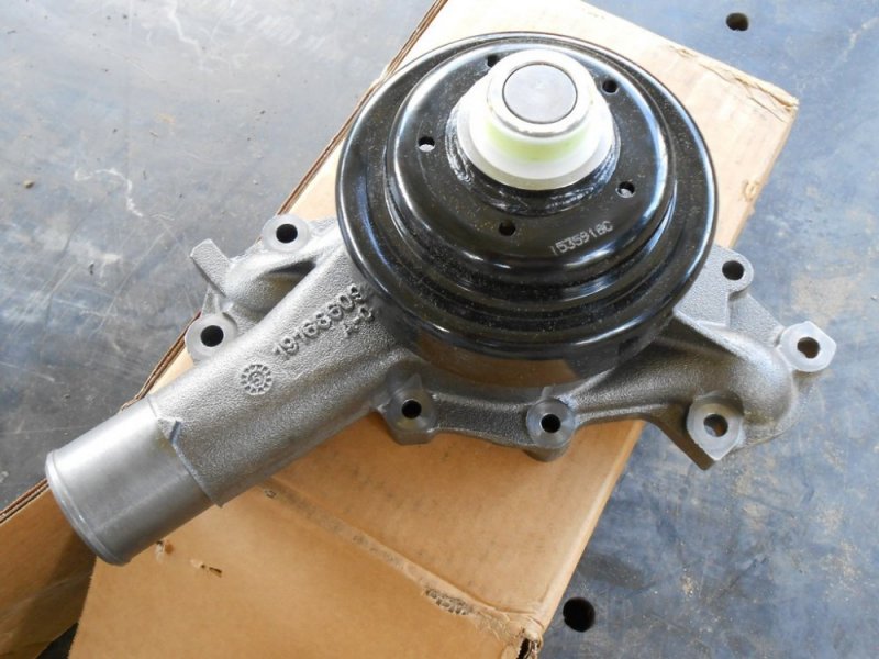

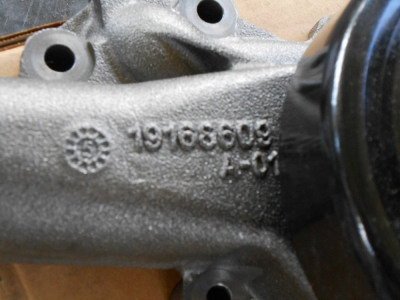

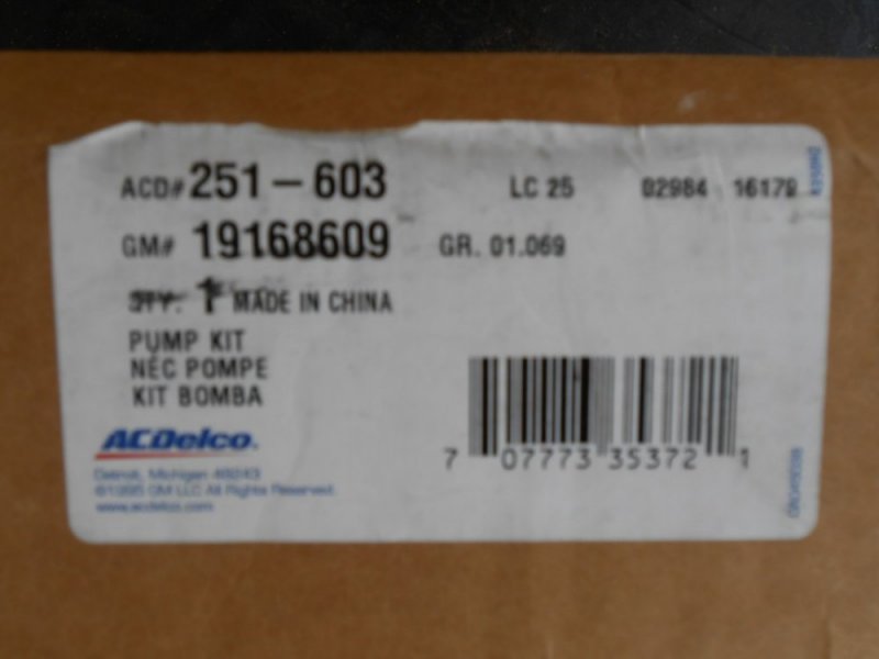

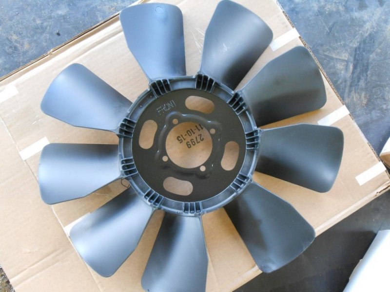

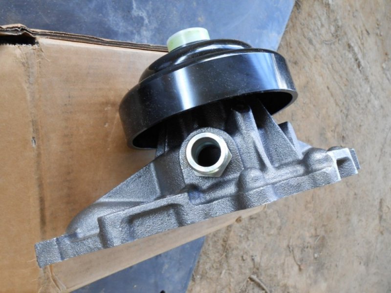

I ordered the 2000 model spin-on water pump version, AC Delco part no. 19168609, a Hayden 2840 Severe Duty fan clutch and a 21" Duramax fan, part no. 15010202. I did the water pump restriction modification by tapping the bypass fitting and installing a pipe plug drilled with a 1/2" hole in it. Everything went fine, no interference with the fan shroud. I had the radiator in the radiator shop for cleaning out while I did the pump swap. I drained the oil and changed to full synthetic oil along with a larger capacity Wix oil filter and changed the air filter too for good measure.
Shakedown run indicated no leaks or problems. But, I did notice that my water temperature never rose above a max of 170 on the dash gauge. It normally ran at the 185 range under normal conditions before my excitement. It would max at 210 under hard loads before falling back to 180-185. I guess I'm adding 2 new AC Delco thermostats part no. 12559336 to my dual thermostat housing.
