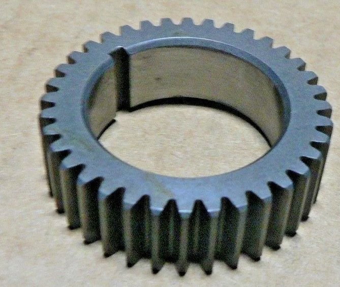

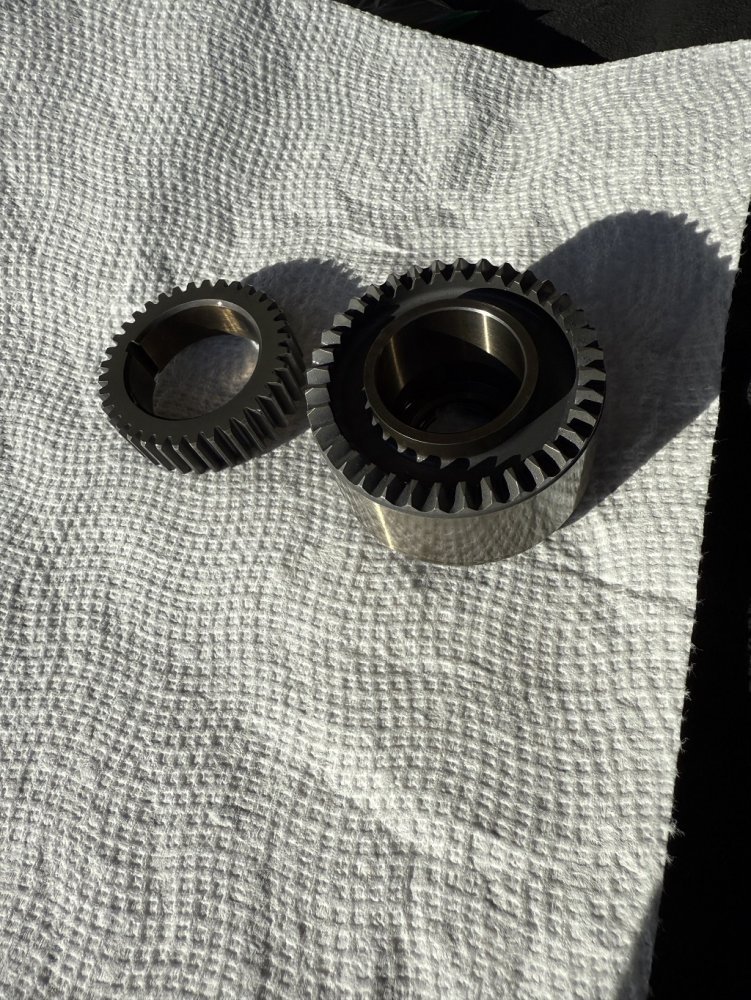

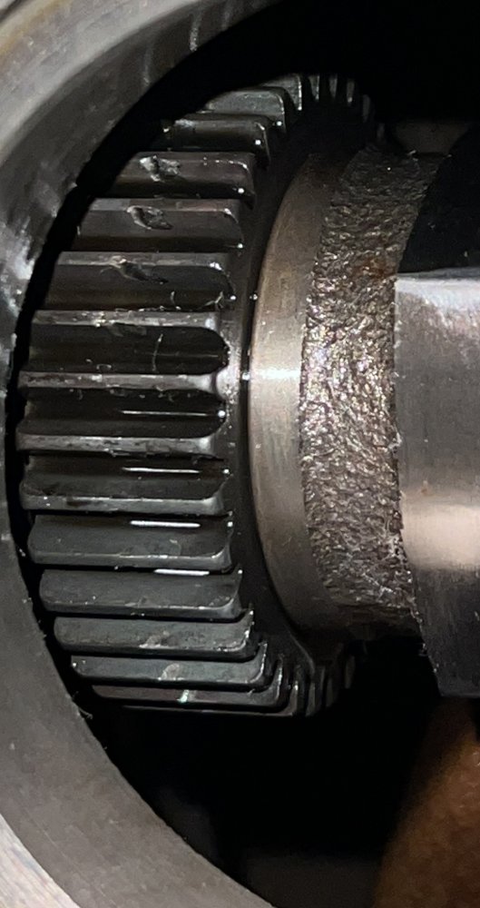

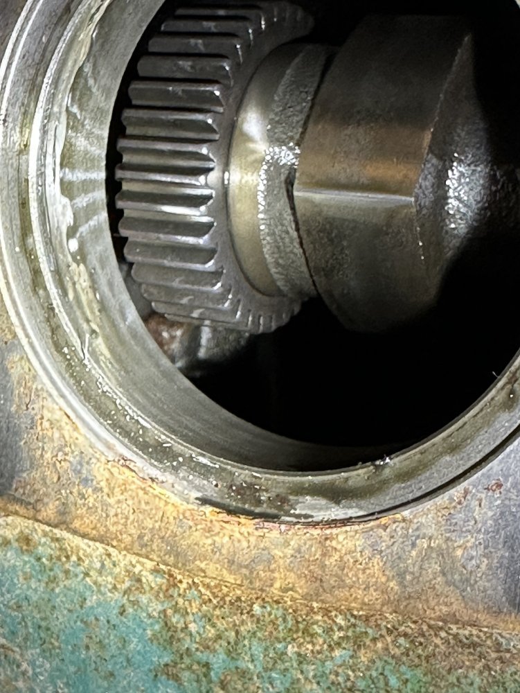

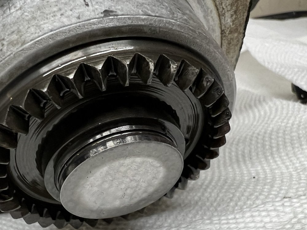

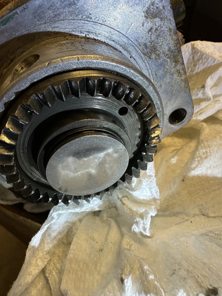

I am working on a 12 DJC Onan 12KW generator and have severe wear on the gear drive for the injection pump. The camshaft gear that drives the pump is available and replaceable, but, the injection pump gear is unobtainium. I bought a parts set just for the injection pump, but, it's starting to show wear although not as bad.
It's a big job to rip the camshaft out to change one gear. :banghead: I am not thrilled to use parts showing wear.
Is there a coating that could be applied to the used IP gear to help? Or would I just coat a new camshaft gear and run the newer pump as-is?
Current set
IP
IP gear
Cam gear

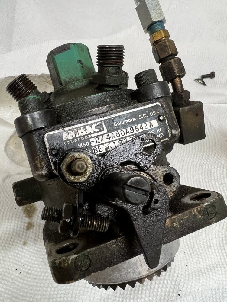

Pump from a parts unit and it's gear wear.

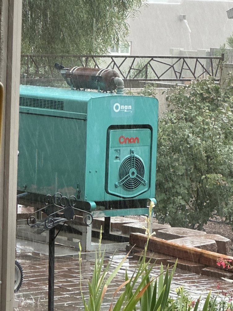

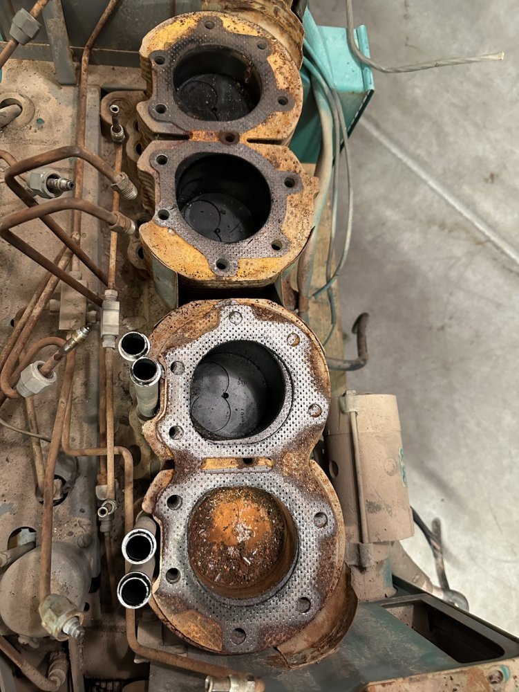

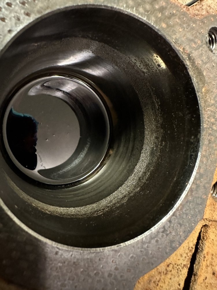

I would have just swapped the complete generator out with the parts unit but it drowned in the desert. Water in exhaust.
After knocking the rust off it needs to go OS or sleeved. Not worth the $$.

The cam gear is replaceable as part of a big job. The IP gear is able to be removed from the pump, but, it's the part I can't get new. The gears are the only item needing repair.
My question is coating a new cam gear going to do any good with the existing IP gear wear?

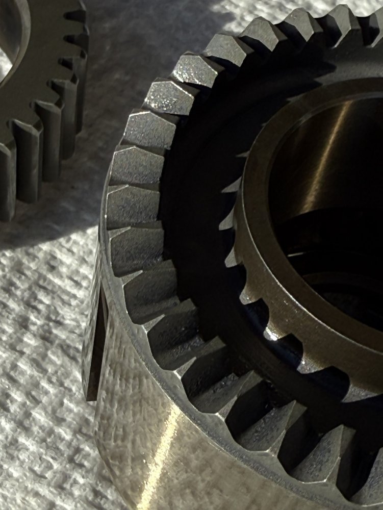

That's an odd way to drive an IP. I've not seen this setup before. I wonder if something could be made to replace the IP gear. maybe of a softer but hard material that wouldn't wear the cam gear out. or vice versa. maybe something made from billet aluminum

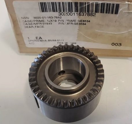

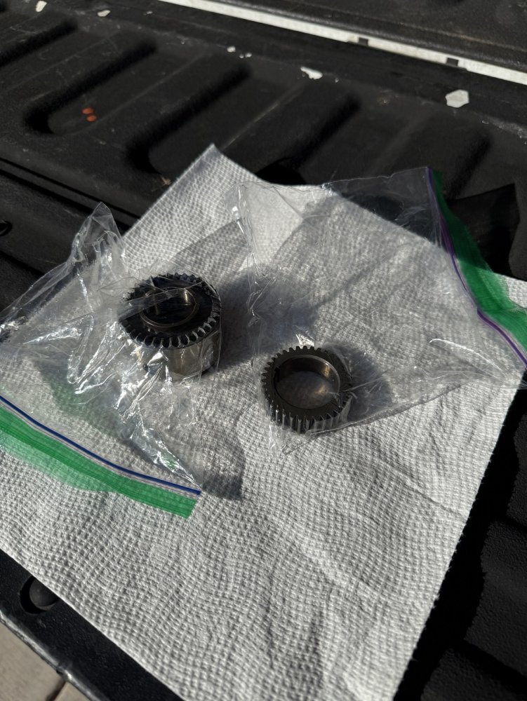

Wasn't really looking just checking if it was even available and I tripped over a NOS IP gear. I ordered both gears as NOS as the cam gear is more common to find.
Do you coat both gears?
Does the coating affect the clearance of the gears? If so I would need to add a shim.
Cam gear major job to get it swapped. Pull camshaft...

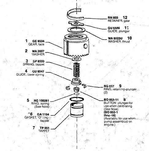

IP Gear. And it's going to be real fun to install it. Requires a press to put clips in...
The fun part: The retaining ring requires a special tool, easy to make I read , to install with a press.
