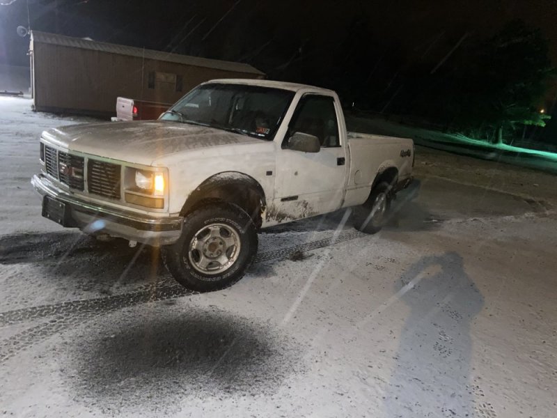

I have a 1989 GMC 1500 that has a 77 Chevy 350 swap with matching 4 speed. The transmission had a slight rattle noise at a higher RPM when I got it. I got in at one morning and started it for work and the rattling noise was so bad I thought it was knocking. It hasn’t quietened any since. The noise sounds like it’s coming from behind the inspection plate on the front of the bell housing but I don’t know what the noise is if anyone has dealt with this and can help me please get a hold of me. Any help would be appreciated...
