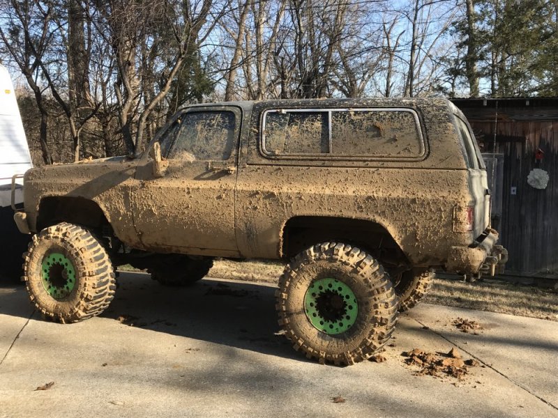

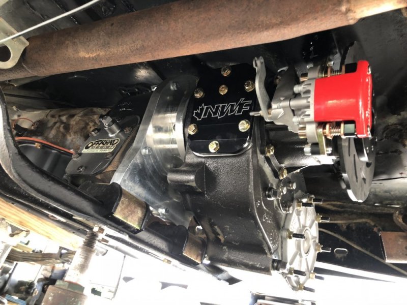

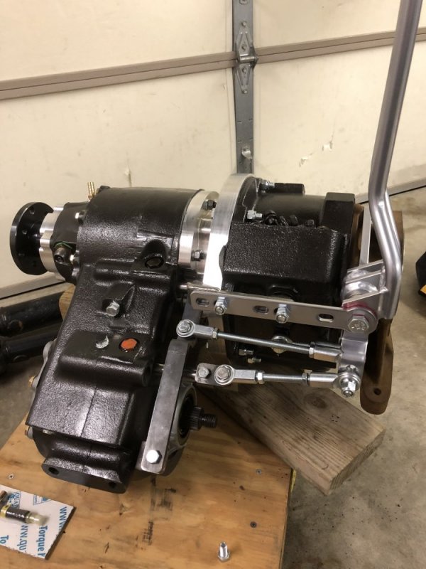

Thanks for all the fast reply’s. The blazer has a Dana 60 and 14 bolt axles out of a m1008 with 4.56 gears lockers front and rear. We busted the aluminum 208 tranfercase early this spring. So I just added a 203/205 doubler. Truck rarely sees any rpm over to 2200. When I had the 208 in the truck it wouldnt pull high4 In uphills or any thick mud. I know the doubler is going to help a lot. But I would still like more low end grunt. And sense I picked up the totaled 6.5 I waesnt sure if the turbo would be good or bad for the 6.2. I know I can’t run more than 10lbs of boost to the 6.2 or blow head gaskets. I’ve already added guages and a EGT gauge. And turn the pump up a little over a 1/8 for now. Oh I live in Clarksville TN. Once again Thank you for all the reply’s. 42DD9279-D8EA-4683-BD5F-02488C61050D.jpeg904AAFB0-DFFC-4161-AA2E-F3778BF5D44C.jpeg2176C0A6-4D6D-4C6B-B5EB-1518DE747D3E.jpeg0FF2047D-3B40-49BD-897C-9C446DE33C77.jpegAE4FF715-4FC0-42F0-92CE-1CD8AF0D1E55.jpeg

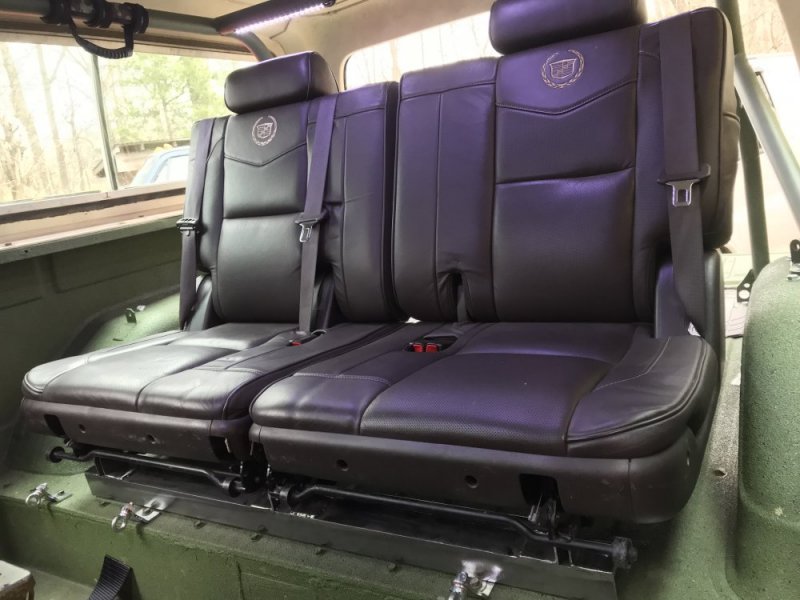

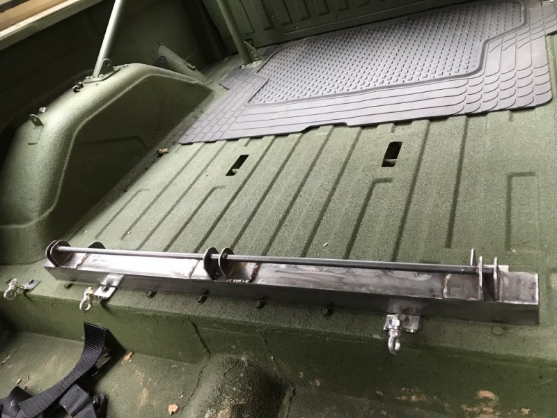

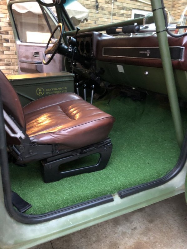

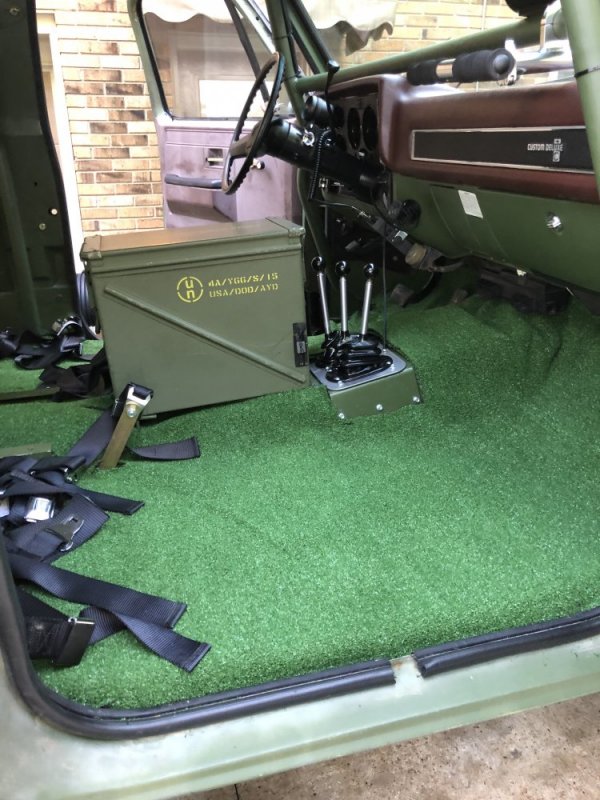

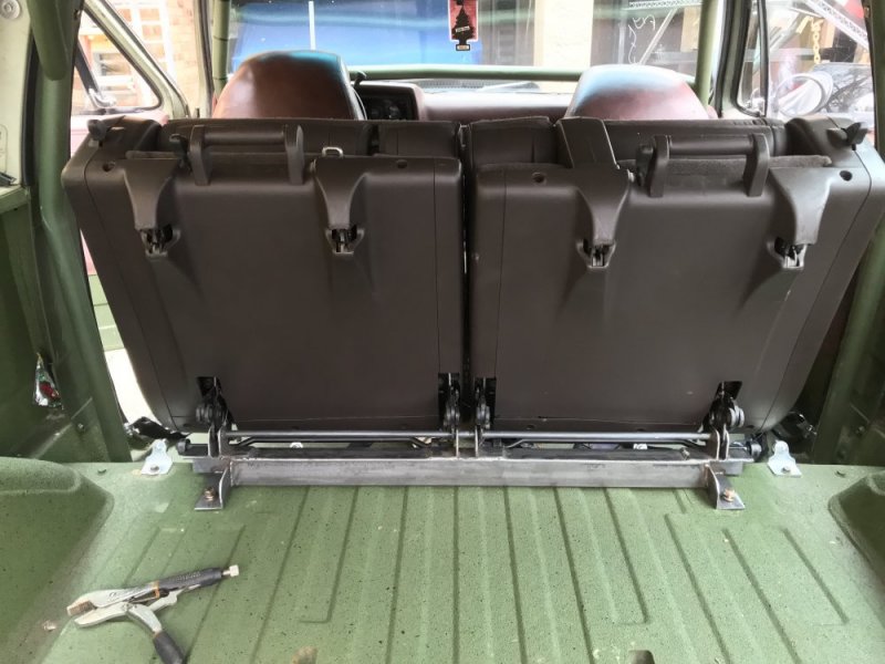

I added the Escalade third row seat for the kids so they could have a shoulder belt. They were getting beat up pretty bad in the factory seat. I know the turf is kinda weird but it really helps on the heat that thing puts out though the floor. It’s like riding in a oven in the summer!!86FC3A73-E665-4C35-89B8-9020D7EB16F3.jpegE0A7FB0D-AE19-4A6D-B9B3-59495A093503.jpegDDEA5F0E-C867-4194-9199-AE3610372A72.jpeg6115B410-D943-457D-98B8-12884F2C42E8.jpegB03C3F1C-305D-4578-95A6-EB10B5FB33D1.jpeg

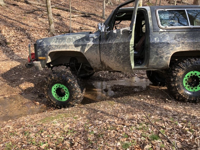

Awesome truck. Don’t hide the floor grass- that’s wild and different. Heck, you could drive barefoot and feel like strolling through the park on a cozy day. If it’s how you like it- enjoy it- don’t worry what “they” say. Half of them drive hondas so what do they know.
With those gears and tire size, and the slow top speed you drive being trailered everywhere- yeah you could get away with the gm baby turbo. I hate saying it. But only because there are much better options out there.

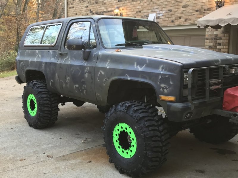

All the mud on that truck, I inow you are runninghigh rpm to do that. A typical play day with a video camera on the tach would tell ya he story.

Thanks for all the fast reply’s. The blazer has a Dana 60 and 14 bolt axles out of a m1008 with 4.56 gears lockers front and rear. We busted the aluminum 208 tranfercase early this spring. So I just added a 203/205 doubler. Truck rarely sees any rpm over to 2200. When I had the 208 in the truck it wouldnt pull high4 In uphills or any thick mud. I know the doubler is going to help a lot. But I would still like more low end grunt. And sense I picked up the totaled 6.5 I waesnt sure if the turbo would be good or bad for the 6.2. I know I can’t run more than 10lbs of boost to the 6.2 or blow head gaskets. I’ve already added guages and a EGT gauge. And turn the pump up a little over a 1/8 for now. Oh I live in Clarksville TN. Once again Thank you for all the reply’s. View attachment 53967View attachment 53968View attachment 53969View attachment 53970View attachment 53971
OMG, That's one awesome Blazer......perhaps the best I've seen lately.
OH, I didn't see you are new to this forum 'so a warm welcome.'
