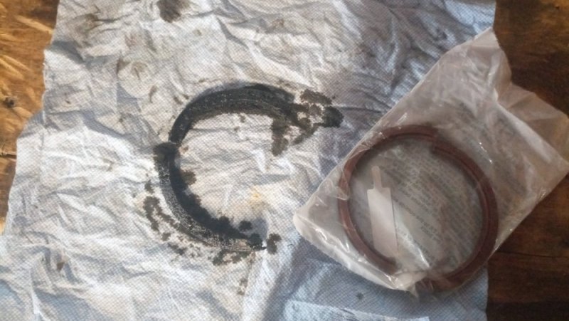

My 84 started leaking real bad a few days back from what appears to be the rear main seal. It probably still has the original rope seal so this isn't too surprising. i will probably change it out this week, but i am wondering about my CDR.

ill try cleaning it up in the mean time, but i'm gonna try to get a NOS one. still gonna have to replace the rear main. the bottom of the truck is coated now. it lost about a quart today over about 140 miles. went from a drop or two when parked to this over the last 3 days.

i intend to replace the rear main seal. i'm not looking for a way around that, i just want to make sure the cdr is working so the new seal has the best chance of working.
