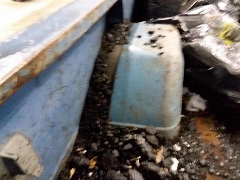

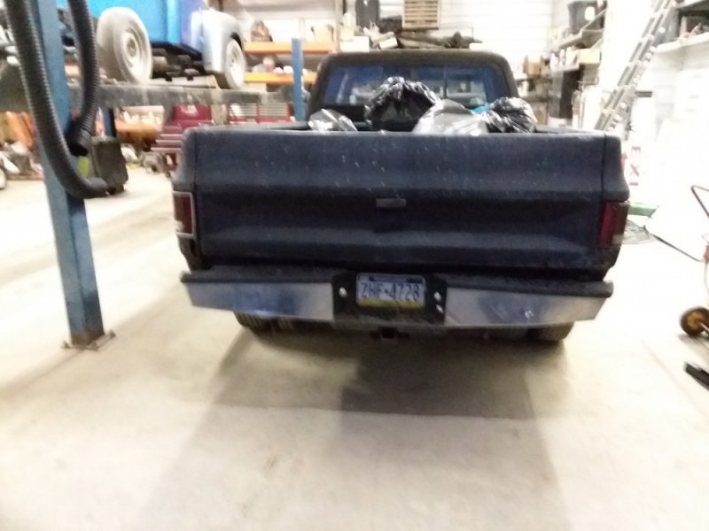

It took me 6 hrs to fix the wiring for the lights. Had the headlights and turn markers in the front all working in about 2 hrs change both headlights. Then I crawled under the bed what a disaster was like a rat nest wires and but connectors everywhere removed 2 lamp cords. Frame looks good beds shot cross members are rotted out. Might look for a donor truck for bed and wire harnesses

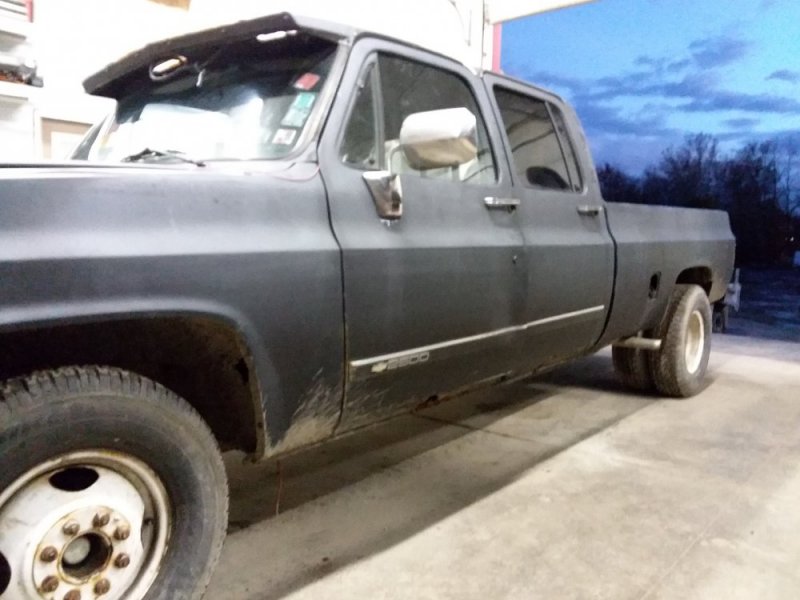

It's funny the outer wheels fit into the fender wells the inner fender has to be made wider
