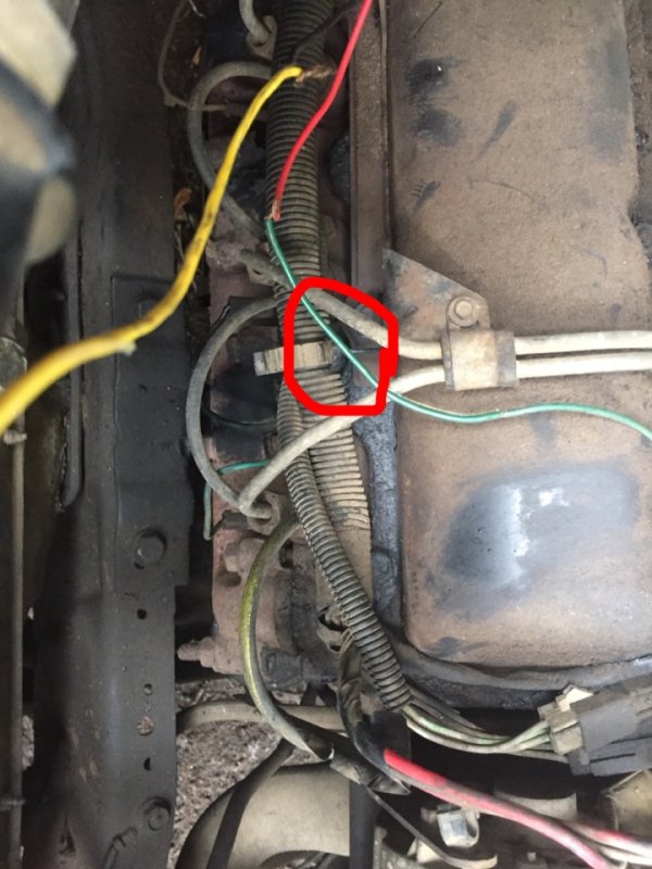

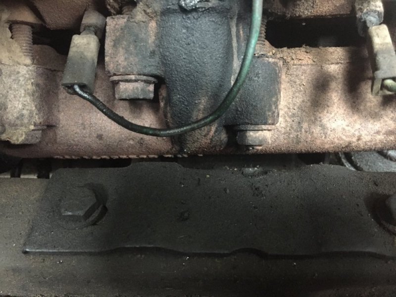

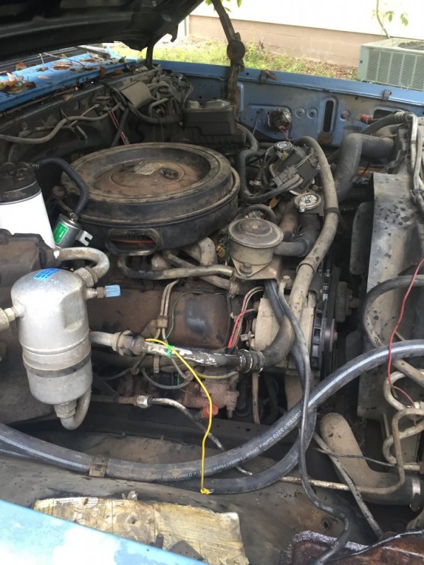

My 83 blew both head gaskets last sunday after overheating (worst day in awhile). I can't pull the manifold because the motor mount is broke. Is it easier to pull the entire motor over trying to change it? One stud actually finally broke off you can see where it had been rubbingIMG_0103.JPGIMG_0104.JPGIMG_0107.JPG

Budget, miles on engine and how many more miles you need out of it- is the question.
Les described the right way to only do heads in your situation to fix mounts and pull heads in place.
But being an 83 that looks it hasn’t come out yet- I would be pulling the engine out and disassembled on a stand.
Chances the head gaskets are blown and the shortblock is perfect or that the heads are perfect is not favorable odds.
Pull all apart, and see what it needs.
You might use the ip of this engine on the other engine that is coming out for the cummins swap and drop it back into the 83 if this one is shot to heck.

Yeah, It’s scary buying parts before disassembly. If you pull heads and find that they cracked or warped and not just gasket failure, that kills not just cheap option but parts cost too. Ruined set of heads or cracked block or warped block surface ends all options of reuse cheap.
The +.10 gaskets dont fix warped. There is a line of thinking I can’t agree or disagree that the thicker gasket might allow easier blow. I see both sides of argument and no one has empirical evidence that I have seen to show either.
Do you already have the new head gaskets and tty bolts?
Do the block of wood, get the engine supported to right height. Yank the heads and then order parts afterwards.
Felpro or victor reinz only on gaskets and new tty bolts. Carquest branded bolts are Victor reinze IF same part number of GS33193.

Let us know what you find. Make sure to straight edge the heads and block. If you don’t know how, we’ll find a video.
Speak up before you buy anything, folks might have new stuff they will sell cheaper than stores. Like me possibly- I already have 2 sets of new Victor tty bolts and 1 new felpro head gasket. But am considering wether to use them in my build or sell them and get arp head studs and may need +.10 gaskets, or might try to find the older victor reinze head gaskets, or maybe the new ones that are under the Mahle umbrella.
I wish someone out there with solid reputation knew of cometics with huge fire rings that are reliable for the 6.5.
And on the motor mount- can you weld? I used to weld up solid motor mounts all the time- ya feel it shake a tad more but it holds the torque better on hotrods. 1 hour welding is cheaper than new rubber...

Like Will said, check and make sure the deck is straight and the heads are straight and not cracked to bad.
If you wind up being able to reuse the engine and heads or some other heads save your money on head gaskets. I have a brand new never opened set of stock 6.5 felpros that I’ll send your way. I bought them when I put mine back together after blowing a head gasket but decided to try the +10 felpros so they are just sitting behind my back seat collecting dust.

This is an unreasonable expectation in all numbers. You need to know if the heads are good or cracked. The rings are hurt, period. Swapping an engine adds up for the little krap like engine mounts, manifolds, gaskets, hoses, etc.
When used engines cost $950 I was still at $2000 total to swap the engine. It took a week to do. Used engines now cost $2000. Still cheap after blowing a $10,000 Cumapart engine up.
Again see what side blew with tstat housing off no belts. Bubbles give it away. Then check the heads for cracks. On your budget you will have to push the rings as far as they will go. Check for cylinder cracking.
The engine swap is harder on time.
At the end of the day this is a 30 year old historic vehicle. They are not exactly trouble free due to age. $50 and $100 you to death they can.

I can’t start it because it’s lost so much compression. I’ve got a 94 that I can use the motor mounts and little things off of. Going to put a new water pump on before I drop it in. The 94 gets to 210 10 minutes after being started on a 60 degree day. Pretty sure impeller is gone. Motor runs awesome though. I have this and next weekend to do it plus the evening after school. Gonna drop that motor in it. Really wish I could use the turbo but a/c is in the way. Don’t have money for banks manifolds. Which does better n/a a 6.5 or 6.2 or can your really even tell a difference?

Also found out some of the plastic retainers for the harness that are on some brackets by the manifolds melted- yes melted. I’m about certain the motor or at least the heads are gonners. Kicking myself for not fixing the temp gauge earlier. I don’t know why it overheated so bad in the first place unless the impeller on the water pump is gone on this motor to.145DEE66-0C10-4517-871D-A7DE8DB61999.jpeg
