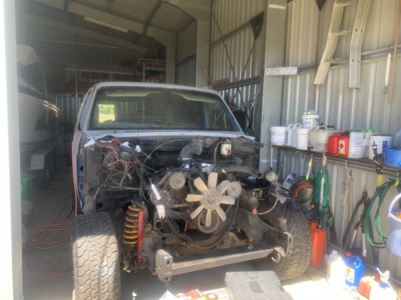

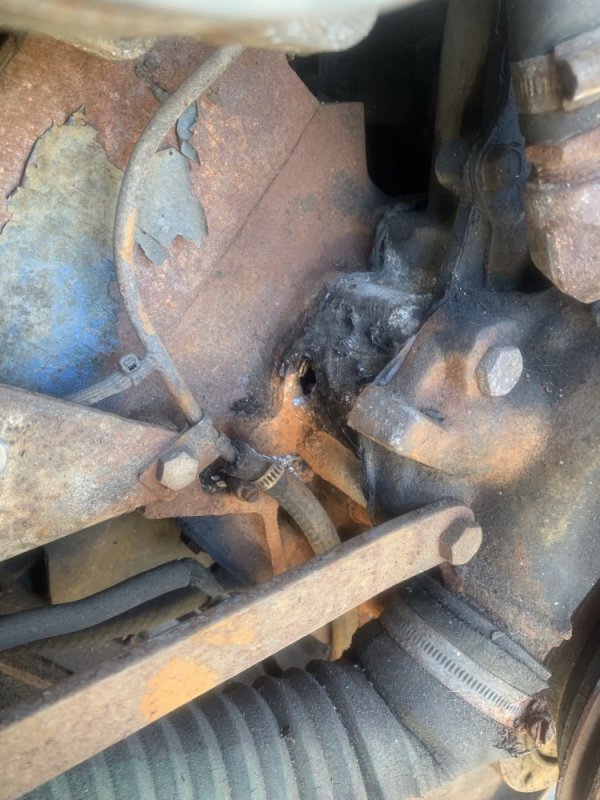

TThe kinked water hose isn't helping. I would check the 6.5 real careful to make sure it isn't a burned up boat anchor before spending a lot on it. Specifically look for cracked main bearing webs, head cracks, and signs of overheating. I would put a set of rings in it while it's out because you don't know how it it got with that cooling system mess. Anything much over 210 and the rings loose temper. Serious overheating 235+ gets you sudden lots of blowby due to overheated ring failure.
I have some of those covers if you need one. Is eBay a good way to ship international to you? IDK about shipping used auto parts Down Under.
Once you know for sure if you have a good engine to work with then you can decide on what direction to go.
