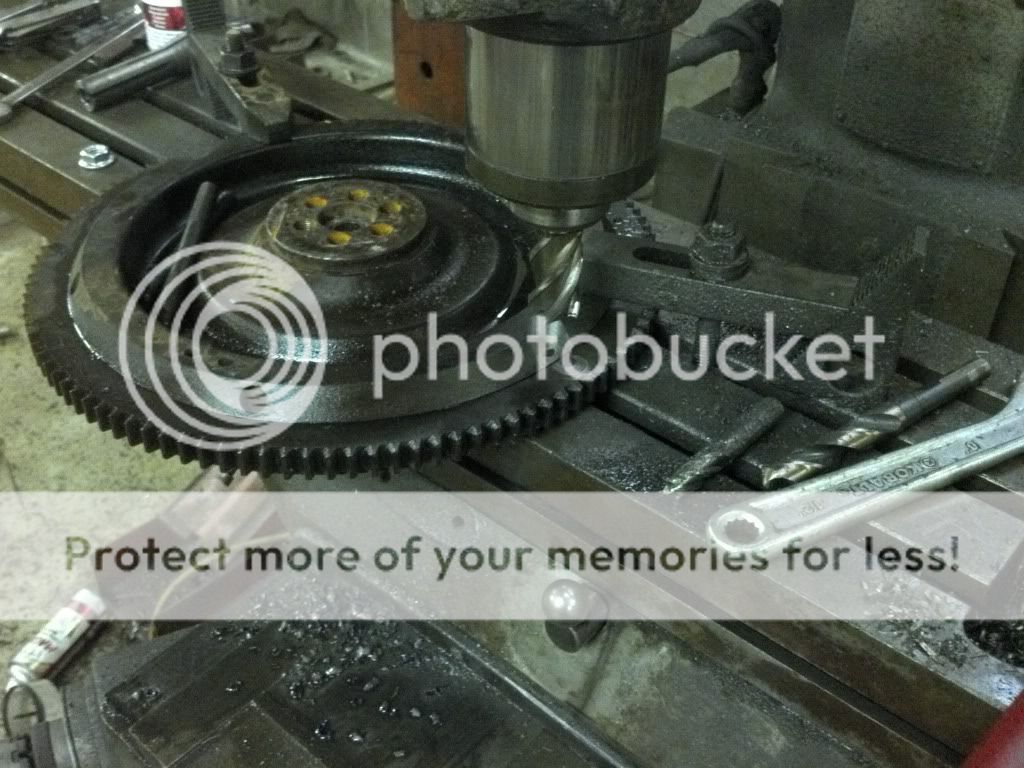

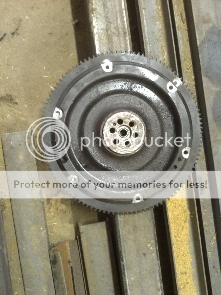

Yanking out the 6.5 and installing the vm soon. This is just the start of the thread, so I have place to post pics, and interested folks can follow the progress.
So far, we got a flywheel made, and intake remade. Pics will be posted as i have time.
