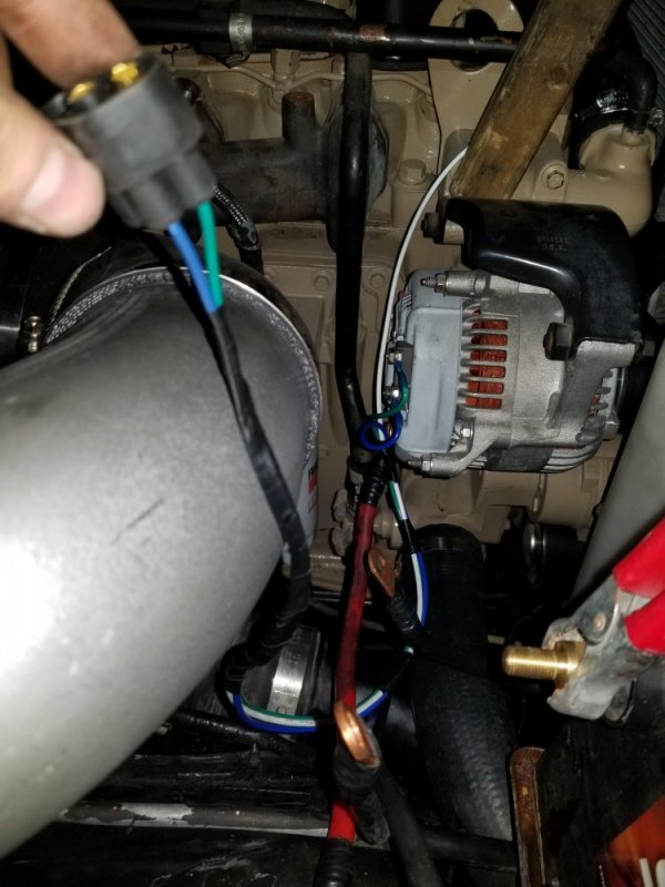

So here's how I wired it. I tested my regulator IAW the video above. I got like 5.84, so I dont think it's right. However, I'd like to double check that I actually wired this correctly. The blue & green wire attach to the alternator two small terminals & the white wire is an ignition wire that ties into the blue wire which goes into the voltage regulator. The regulator is grounded to the fender. One of the mounting screws also has a wire that runs directly to the battery negative.
Your regulator is way out of spec of "1.75/1.76" for the Denso alternator, the ground from the regulator should be to the alternator case and alternator case ground to battery.

Are these problems only related to the denso alternator? If I had a remanufactured one from Remy, would that make a difference? I will rewire the regulator to be as you specify, but just out of curiosity, couldn't I leave my wiring & just run a ground from the alternator case to the bat negative & get the same effect? They are then both grounded directly to the battery negative which from what I understand, can't really get a better ground than that.
