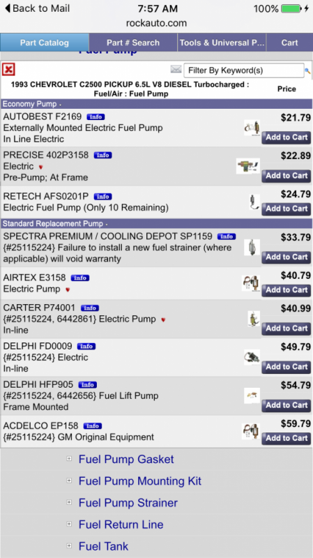

Rock Auto is a vendor, here is a snapshot of '93 list today. What would I buy- the ep158 for $58.79. If everyone is as good as the ep158 then the cheapest one would be ok. Give me the first 7 for free and I would put them in my truck-only use them to throw at whoever cuts me off. But as far as pumping my fuel? No. If I am broke at the time- I would use a junkyard one because its way cheaper and installed in 4 hours. Ok if I am broke and someone gives me 1 free I would run it. But no way would I buy one if not in a serious bind.

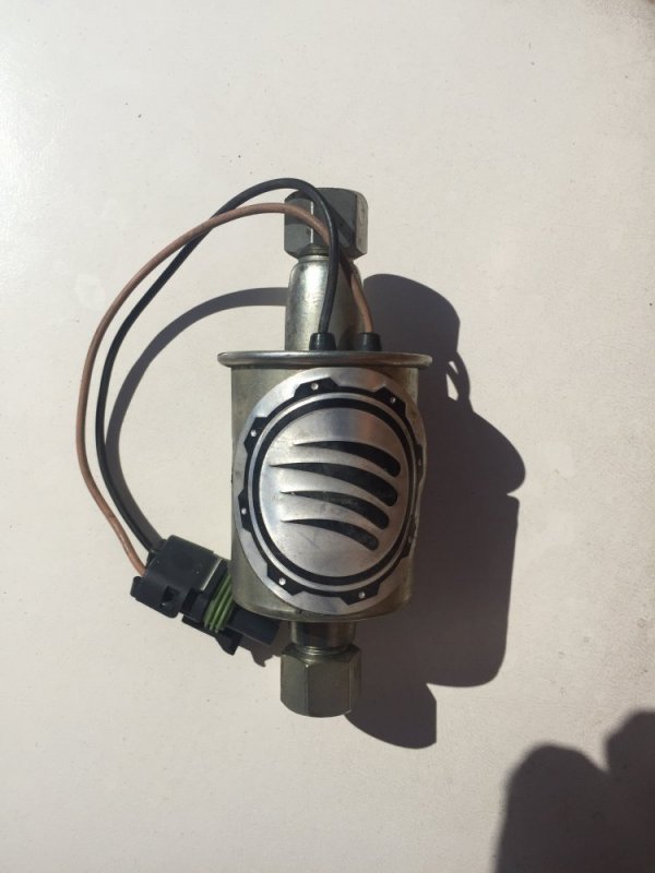

Will, when you pull up the pictures of the Airtex and the AC Delco it is the exact same picture with the same part number on it!?

Airtex makes total P.O.S. pumps. Looking the same and a similar number means jack squat!

They don't look the same and have similar numbers. It is the same picture of the exact same pump with the exact same number on both of them. So how much squat is that???

Wasn't trying to be a jerk to you. Sorry if it came across that way. My anger is at them trying to rip people off with misleading practices. The difference in the part number is subtle.
EP158
E3158
P vs 3
Notice they even do a label that looks similar to the AC Delco.
Airtex makes horrible copies of whatever the best quality part is, and copies the part number as close to possible to confuse customers tying to buy the real deal. Don't fall for it. Looks like they had you on the line with the marketing trick- be glad you asked hopefully you havent ordered it yet.
