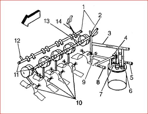

@MrMarty51 The oiling diagram out of the military repair manual explains this. Priority oiling to the cam bearings... So if they get loose you loose a lot of pressure. It could also be a lifter bore. There is an oil cooler bypass valve and oil filter bypass valve in the oil filter area.
That explains a LOT. Thank You.
