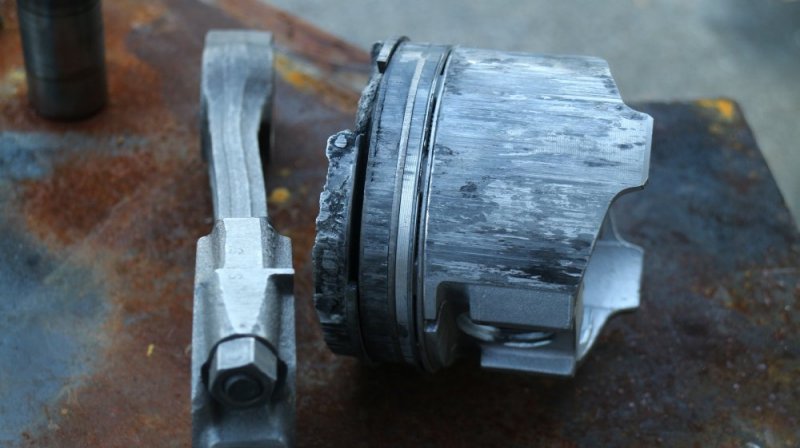

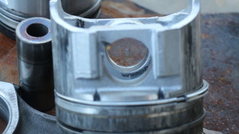

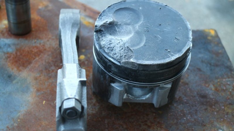

My solution was to put a turbocharged 6.5 in it. which worked great for a year till one of the cheapo pistons I bought decided to melt itself to the cylinder wall and then split that same wall when it no longer fit. All on flat ground cruising. Engine wasn't even fully hot yet.

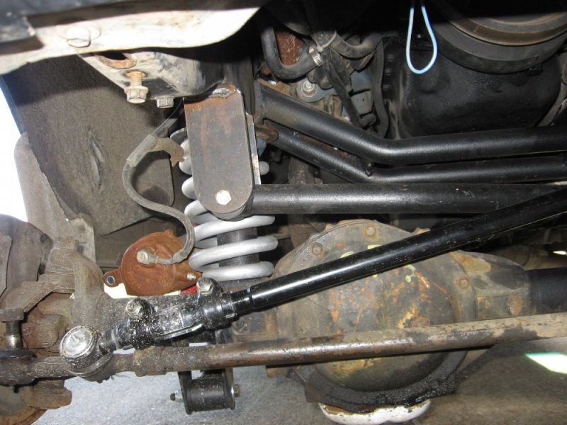

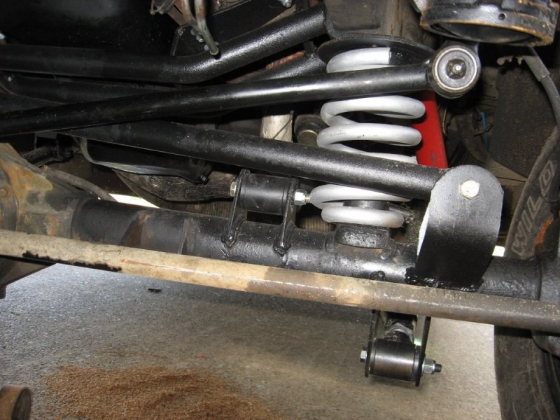

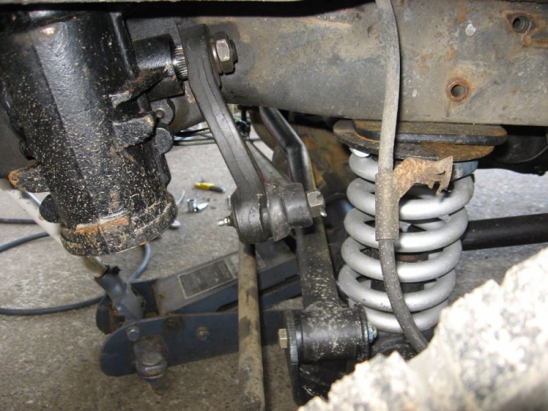

Some years later I ran into some guys that claimed they could put a 4x4 front axle in it for a reasonable price. They were wrong and I have been fixing it and teaching myself 4x4 suspension basics and fixing it again ever since. They took a spring from the front of a regular van and cut it in half. they stuck each half between the axle and the frame. Then they cross the drag link and the panhard bar so those formed an X shape. The axle was located by what looked like some kind of 3 link and they told me it was a 3 link but really it was a radius arm on the drivers side and a single link on the passenger side. Rode like crap and blew all the seals out of the steering box on the way home. I got some ford f250 spring buckets and springs from the junkyard and made them put a real suspension under it and made them put the panhard bar as close to the drag link length and parallel as possible. it was drivable then. I have since put a 4 link under it with cheap coilovers. I have plans to get more travel out of the coilovers which means I have to rebuild all the brackets. but that is another story. Oh and I did put a nice limited slip in the front when I rebuilt that because the axle they gave was pretty much rusted junk. And that is where we sit today..
These pictures aren't very good but you can see how they mounted the panhard bar and the draglink and springs.

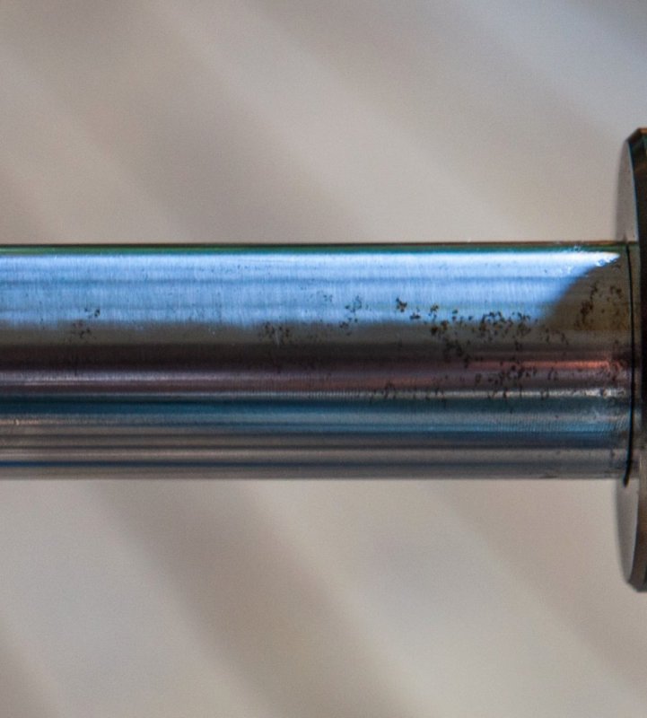

Nice closeup of the pitting you get with a cheapo FOA coilover shock. Apparently FOA stands for First OverAll in the trash bin. And no they have no interest in making it right. Basically there is chrome missing and or it is thin enough it rusts. The other shock is fine but I have no use for a business that will not take care of its customers.

Nice scuff job on the pistons and the cool offset rod!
That's a nice Rat Rod van going 4x4 and all like that! Rat Rod: From the fan, engine, trans, to and including the rear diff. The Rear Diff is the ONLY thing I haven't had to mess with on Patch other than all 3 oil seals.
Absolutely carnage thread material with the piston melt down and rod!
You like that eh? Those pistons were crap. How much force does it take to make an offset rod like that? if it is already bending then how close was I to instant disaster? That rod really bothers me because with all things being equal it should not have bent like that. It looks like the main side may have been kinked already or something. I dunno, I have stared at it for quite some time trying to figure that out. Maybe the rod was in backwards? I can't imagine doing something like that. I know how they go. Now I am wishing I took pictures when I took it apart all those years ago. Back then all I had was a regular film camera, nothing digital.

What Axle does Patch have in it? If it's the 8 bolt 1/2 ton stuff you are lucky. If it is a full floater than those are already tougher than nails.
