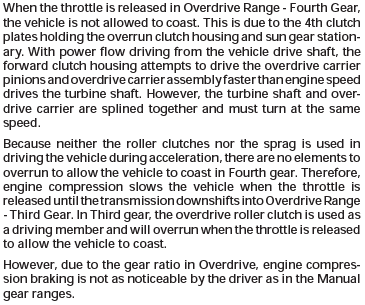

Per the 4L80E manual I interpret 4th as a compression brake gear, see attached snipet. It also says that manual 3rd range is a coasting gear. If this is the case, then when my RPM drops RPM when coasting while in OD range, I very well could still be in 3rd and never even get to 4th. I'm also pretty sure the TCC is locking up since the RPM increases ~150RPM when I drop from OD range to 3rd which is what the manual states will happen (and eventually re-engage)

I don't think RPM should drop if in OD range when is meets all the requirements to be in OD since it is not coasting gear per the snipet I posted above. I need to take it back on the road to confirm if it is commanding 4th. That can't happen right now since I'm in the middle of fixing some other issues (front tire rubbed a hole in a hydaulic leveler line).

I would disagree. What is the point of putting in an OD gear if it only engages when coasting?
Going downhill in a 10,000lb RV at idle RPM in OD (foot off throttle). Normal. Overdrive in these big RV beasts is somewhat an oxymoron. Even when working perfect they don't spend a lot of time in OD unless the road your on is perfectly flat and no head wind. LOL! At 60mph you should be in the 2600-2800rpm range when in OD. Normal.
