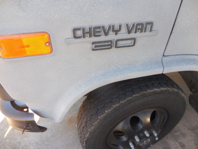

Howdy folks, I've seen some posts pertaining to this transmission, and mine is acting strangely, consequently, I have some questions for anyone that can offer some advice/wisdom.
Here are the particulars of the vehicle:
- 1993 22' Class C RV on Chevy G30 one ton van chassis; fully loaded weight is approximately 9,000-10,000 lbs.
- Original 350 ci motor that was replaced approximately three years ago with a remanufactured 350 motor built with some moderate performance upgrades.

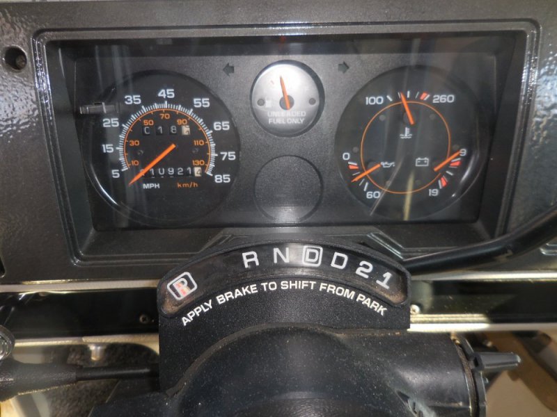

- 4L80E automatic trans. Trans has main D selection, then three lower drive gears that can be manually shifted into from the column.
- This vehicle was purchased new by my father in early 1994; the transmission has been regularly serviced over the years, and this is the first issue of any kind I've had with it; it was handed down to me in 2007. A total replacement with a remanufactured trans appears to be in the 4,000-$5,000 range.
Transmission issue occurring:
- Trans intermittently will not automatically shift past the first Drive gear while in "D."
- When this occurs, I can stop the vehicle, shift into Park, turn off the engine for a few minutes, restart the engine, put the vehicle in D, and away I go, the trans working perfectly. I drove the vehicle to Daytona a few weeks ago for the Daytona 500 and this issue occurred twice on the trip, but it made it back to Texas fine, but is doing the same thing again now.......again intermittently. A "check engine" light also comes on intermittently, but not necessarily when the transmission isn't functioning properly.
