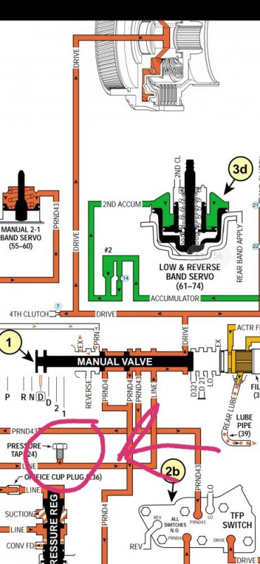

Are you certain you got all the check balls back into place properly? Sounds to me like one got left out.

Another question i have that i forgot to mention. I also pulled the reverse servo out to measure the piston on it. Could that be pushed back in to far causing the trany yk not release reverse and slipping drive due to pressure?
I'll be sure to check that out first thing tomorrow.
