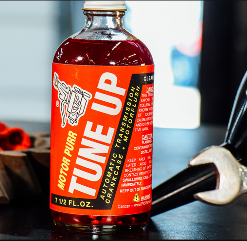

you could try a bottle of motor pur in the trans, then go driving like a maniac for a bit. that stuff will usually flush out anything in the valve body, sometimes will fix the problem. but I would recommend changing the fluid and filter afterwards. then solenoids while your in there for cheap insurance.
sometimes driving habits can account for buildup in the valve body too. what ever you do, don't try "flushing" at a lube shop, that will break loose stuff that will destroy the trans.
