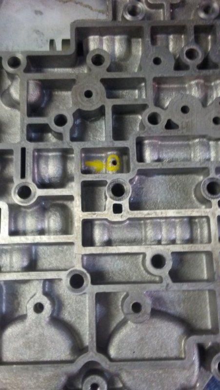

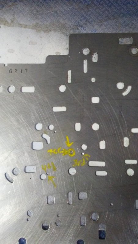

The tcc solenoid inputs varible psi at the front of the valve. At the back of the valve is a spring,and return oil psi trying to push it shut. Its actually a pressure regulator.

It will cause a firmer engagement of the tcc. The first trans I did this to, the tcc was on a toggle switch. This one is a 06 Duramax van,with stock tunning. I do my own tunning, so if there is any issues I can probably correct it.
