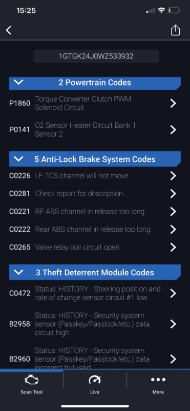

Part 1: Anyways after I bought the truck and started driving it I noticed once would shift 1st, 2nd, 3rd smooth and even Overdrive (OD) if the truck was cold... But once the truck started to get some temperature it kicked out of OD and dropped down to 3rd gear which obviously caused the engine to rev higher at around 3000RPM at 100km/h or 60MPH where as in OD it would be around 2200-2300... Once the truck kicks out of OD it won’t go back in no matter what I try doing. If the truck does happen to lockup in OD if I slow down to where it downshifts into 3rd and I speed up again it won’t shift back up... I have done research and I heard a lot of different answers from potential wiring problems to a faulty solenoid... I am very confused as to what’s causing this, has anyone had the same problem and know what may be causing this?
Part 2: I have thought about just finding a good used tranny and swapping it out and maybe that would solve my headache... So now the problem with changing transmissions is I would I not need the exact same transmission? I would need a 98 to 99 style because the coolant lines are in different places, a 4x4 tcase with electronic push button style not the mechanical on the floor 4x4, and the transmission would have to be out of a 454 (bbc) because the internals are different rather from a diesel or 350 3/4 ton? Now I know you can get away with putting any in 4l80e from let’s say a 350 yes it might bolt up but the inside will have different gear ratios and different just build heavier? Also the torque converter on a 454 has its own speed that it locks up at... This has me stumped because I have done some research and people have swapped them on forums but nobody has discussed this and does it not make sense thatthe internal parts are adjusted for the engine that’s in front of the transmission? I found a 2005 Chevy 2500 4l80e with the tcase 4x4 electronic push button... the transmission has roughly 160k on it but I am unsure if it will work and moneys tight right now I can’t take a guess that it will work and there’s not a lot of talk on the internet with the same questions I ask...
Thanks in advance for helping me, cheers and stay safe!!
