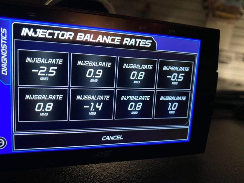

I don't know. I sold the truck to him after I owned it from new at 355,000Looks good, what's the fuel rate mm3 though? Balance rates alone dont tell you everything. There is some math involved to properly check them
I sent him that information some time ago. What he does with it is not my problem.Balance rates without the fuel rate are just numbers. The fuel rate is critical in figuring corrected numbers.
Proper way to check balance rates
It drives me nuts to hear people say there balance rates are good, so how can they have bad injectors? Well they might THINK there balance rates are good, but in reality they can be quite the opposite. Balance rates are nothing more than how far off of the average fuel flow each injector is. All...www.thetruckstop.us
I think an Edge CTS3 unit. But I'm not 100% sure.Nice Mike. What tool did you use to get the balance rates? They look good for 360k.
