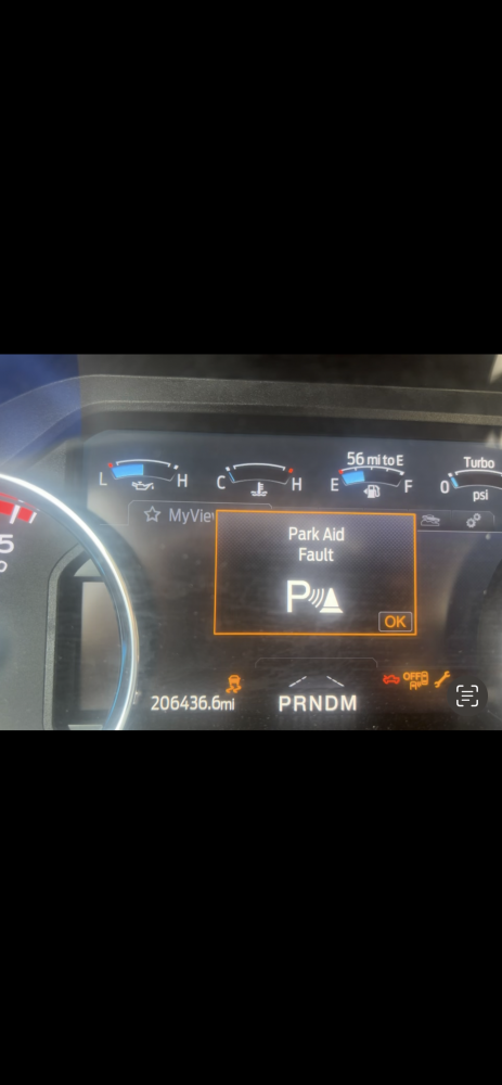

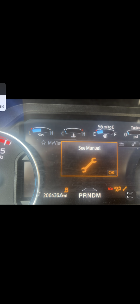

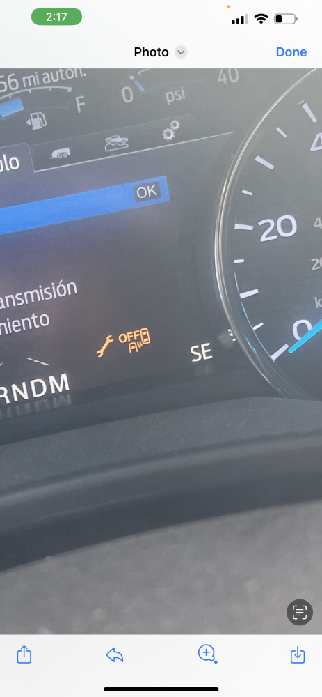

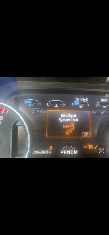

My truck lights saying park side fault keeps coming up but while back the back light would not go off not sure if this could be due to a bad battery or how to fix it! It’s used for commercial and my bf is stuck in a truck stop HELP

Bad grounds and bad batteries can cause a lot of grief.
If I was stuck and could not make miles to deliver a load, I think I would be disconnecting the batteries, cleaning cables and cleaning any grounding wire terminals within My sight.

Do u think a bad battery could do it then it’s allot of stuff showing up when never having a problem before! I am going to call the closest Ford here when they open today! He is still there he said they usually put it in reverse and it should show up but it will let him switch gears but stays in neutral. Not sure I think mab it went into limp mode but awhile back he had his overhead light wouldn’t go off that the only problem he ever had in this truck! And thanks happy I found this page I am a dispatcher and have all kinds of trucks so I can try to help them out :)
That is some mighty useful information, You being a dispatcher. Could call for help for any one of the forum members that would become stranded, anyplace.
A condition of low voltage could cause any number of problems and trouble codes. Could also be related to a bad battery, bad electrical connection or a bad ground, or, it too could be that the computer ECM fried.

It went to ford last night now just waiting to see. If it was the battery I was told it wouldn’t let him change into drive or reverse anything but it let him change gears but just sat in Neutral but I will let everyone know after we find out the problem!
Sounds like this is an upper level (Lariat or Platinum) equipped truck with Fords driver-assist/collision assist. My guess is some sensor has gone astray creating a fault within the system so it cant adequately monitor itself/surroundings. My thought is your reverse comments as my old F150 had issues with rear park-sense, and would disable when put into reverse.
I am a bit confused as it sounds like the truck is in limp mode, or is immobile in some manner? Is it showing a true check engine light (or just the other errors?) It should be drivable even with the above assist functions at fault (I wouldn't think in limp mode either). These new Fords (and most new vehicles) have a battery monitor (right on the post usually or on the wire near the post), and can identify battery issues resulting in a fault code on the dash.
This truck shouldn't have electronic transmission shift, so it makes me think that something (such as a door switch/hood switch) is faulting not allowing the gear selected as a safety feature thinking someone may fall out of the truck? But again, this truck should still be mechanically shifted, so I cant see the system overriding that. I have a 2021 F250 (6.2L gas). Ultimately with these new vehicles you will need a scanner, these trucks will tell you what's wrong (or what's not playing nice).
