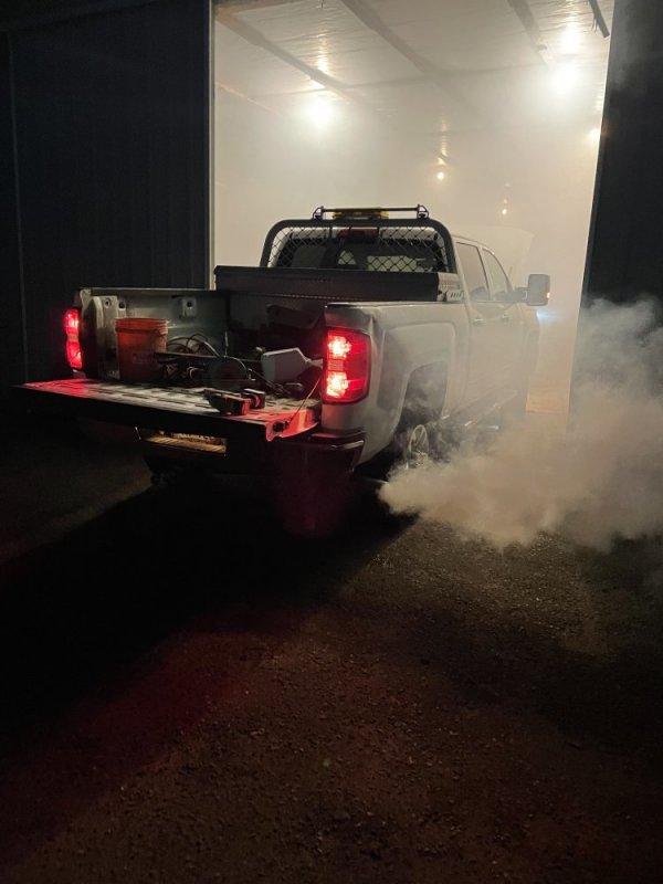

Just deleted my lml with 4 inch exhaust Dow pipe back with muffler got tunes from eco freak custom tuning truck is blowing white smoke and not really running it’ll run then die do you think this is tune related ?

You need to abandon the tune or get ahold of the tune writer to have them fix it.
Your problem is in your tune not matching what you have set up for.

LmL has a cold start logic programmed into it to help it reach operating temperature as fast as possible. If the tuner did adjust for that it will haze if the outside temp is under 50*f until it warms up. Let it run and see if clears up, if it does its the tuning. Very common complaint on thoes. A completely stock truck can haze slightly in colder temps as it warms up
I appreciate that explanation a bunch... I'm now assuming Wehrli isn't aware of it either. Not to worry, it clears pretty quick.
