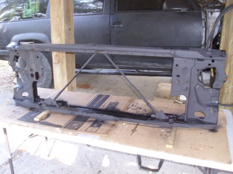

Mine is very similar. However, I need to redo mine. I had to extend the upper radiator hose as the engine is not centered. So I think I'm going to purchase another core support from a junkyard & really make it nice before swapping it out. The other issue though is the intercooler has to be moved as well as it hugs the radiator. So both have to be shifted over to the passenger side as well as dropped down. Right now the rubber "legs" or locating dowels, whatever you wanna call them. The legs on the dodge radiator just sit on the 6.5 support. Theres no holes to locate them. Due to this, the radiator cap touches the hood.
My reason for not keeping the radiator centered with the truck is:
-extended upper radiator hose
- fan comes very close to shroud on the passenger side
-upper water neck touches driver battery
-radiator cap touches hood

I drilled my support for the Ram radiator and the CAC/IC sits flush with the leading edge of the support as you see in the image I posted I even left the diagonal supports in place too. The battery tray can be modified to allow the battery to be moved away from water neck.
