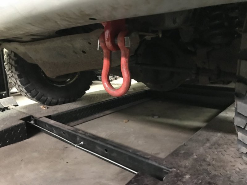

I made a front tow point before the trip. Good thing!! That was used to pull me back to the parking lot with the hydrolocked engine.

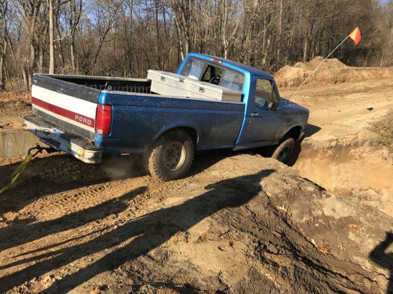

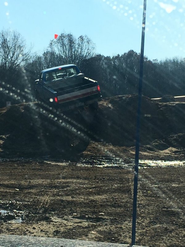

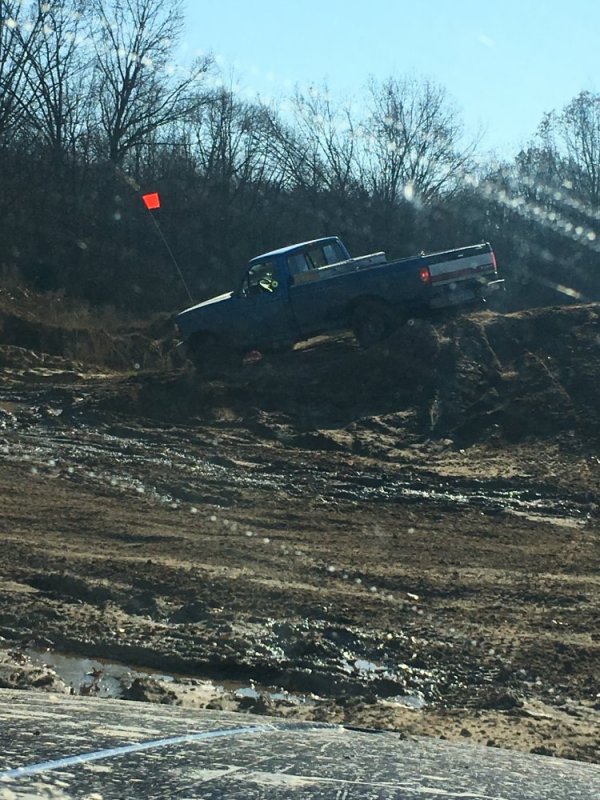

15 minutes in and this happened. I was on a ridge and found where the dirt was undercut from erosion. Luckily this is all that happened here.

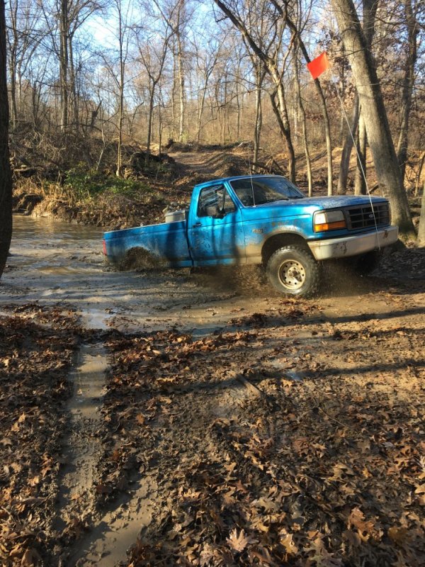

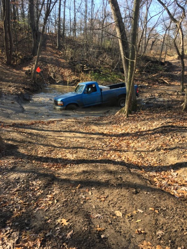

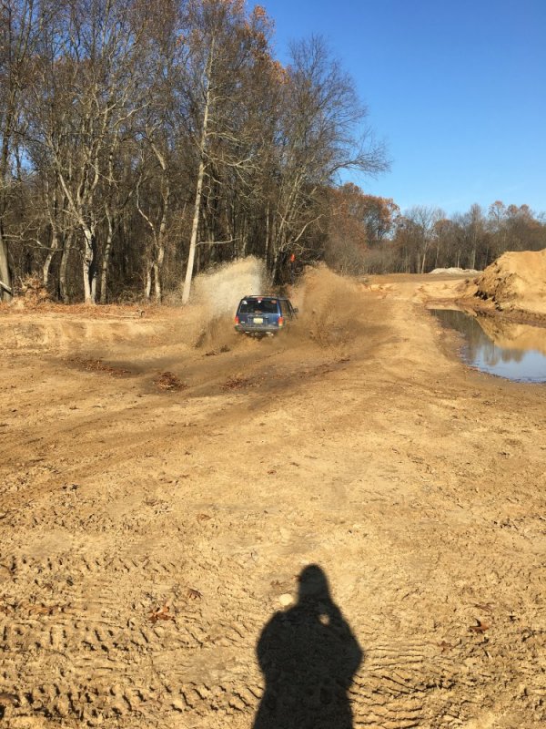

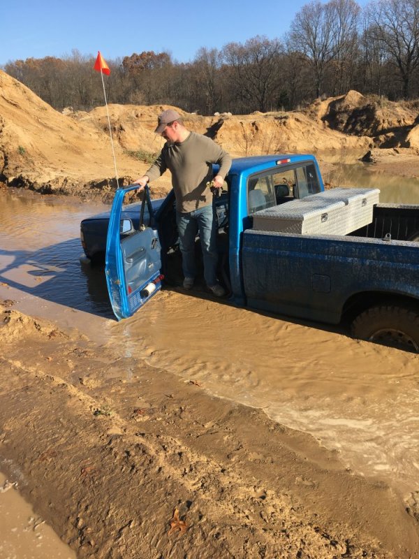

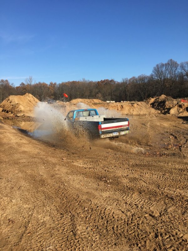

Everything was going well until we found the water runs. My brother hit it with his XJ first. He made it 1/4 of the way before getting stuck.
I was sure I could do better so I hit it. I made it a little further, but then the engine bogged and died. I tried to start it and that’s when I realized it was hydrolocked. Oops.
57AA22E8-C45D-49B7-B4B2-DE0734F3498A.jpeg 1CF45253-5BD6-4956-83A5-01C6FDA581FD.jpeg
Good times and the outcome could have been worse!

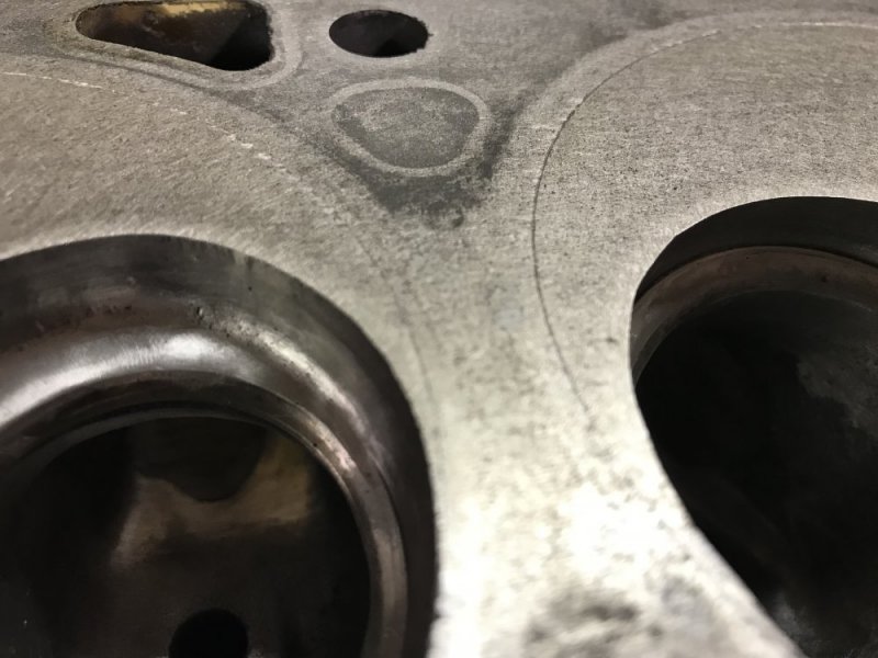

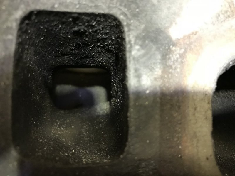

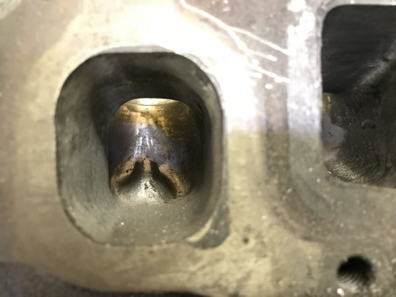

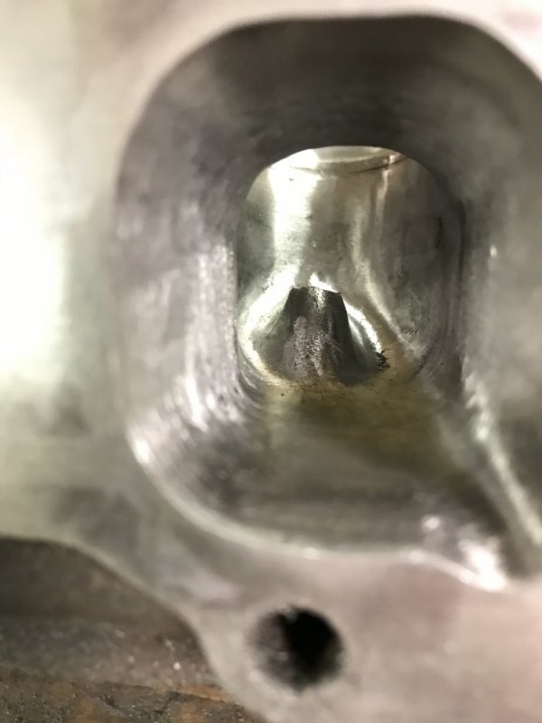

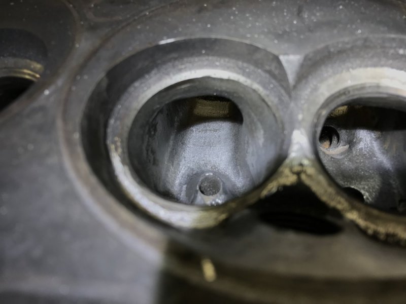

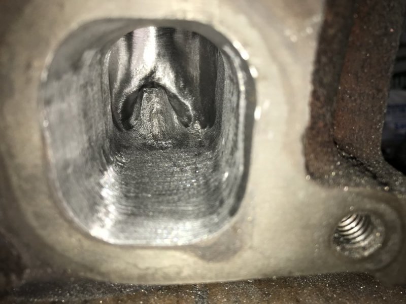

Time to start porting! The head has a fast burn chamber design, so half of the intake valve is super shrouded which creates turbulance that hurts flow but makes power at low rpm. I did a lot of work in the bowls but then just blended into the ports. In the chamber I did some smoothing around the spark plug and then just did some polishing around the valves.

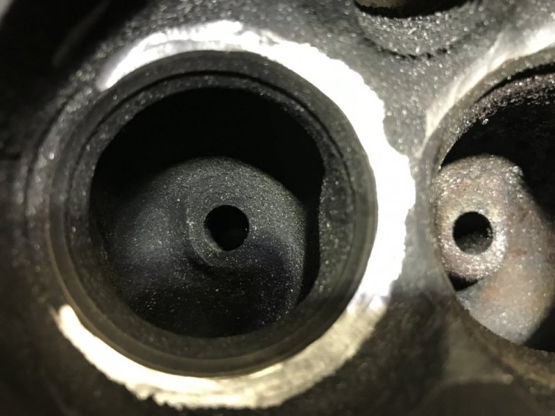

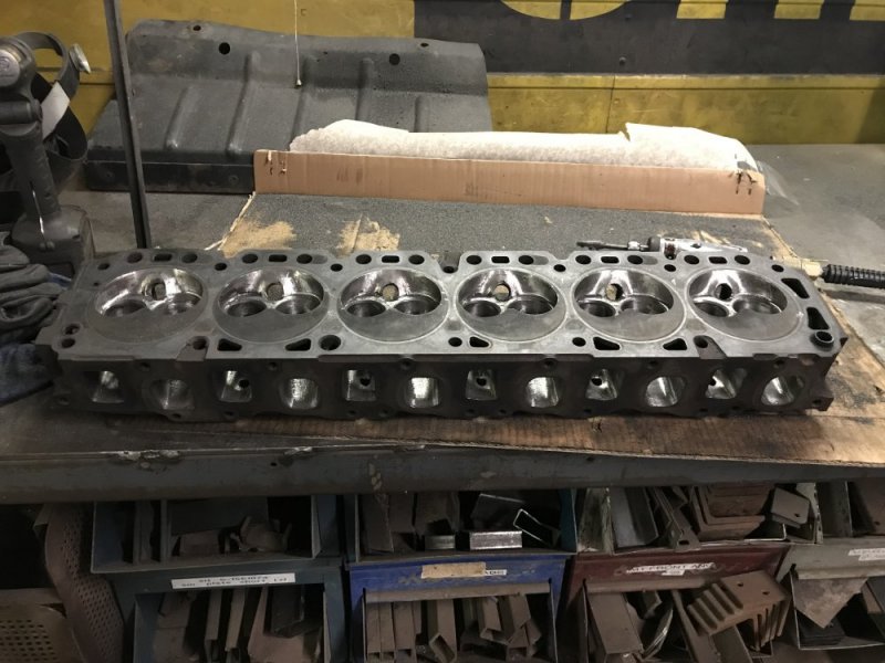

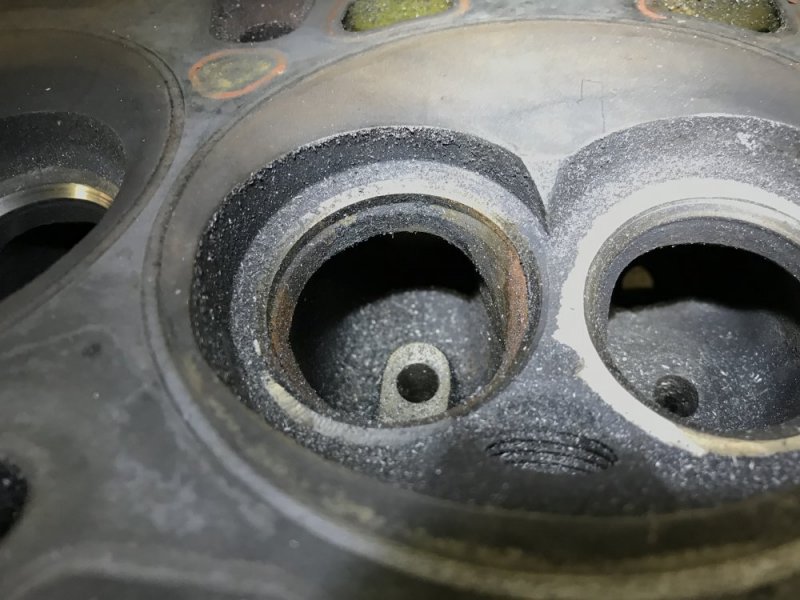

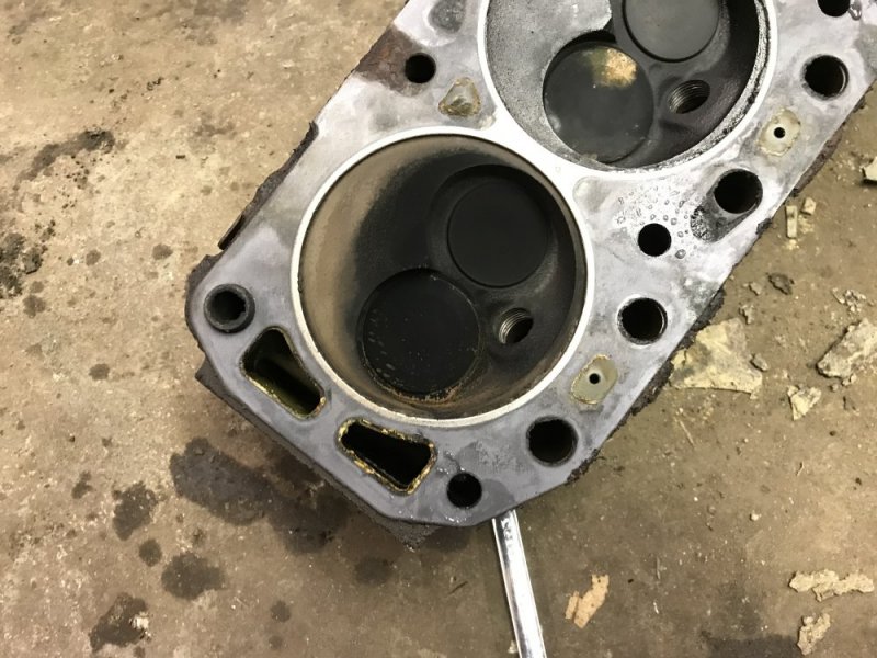

Here’s before:
61E670BA-AF84-4689-89A5-0A6BC829C81B.jpeg CC2A91CF-C934-4145-802A-C86CAE94E524.jpeg 364FC90C-3516-4C20-A924-AE1E315F015B.jpeg DF2EDED6-DD21-45F0-82CA-59D36A3626C1.jpeg E60B6DA8-8616-4571-A8E6-0E165DA959EC.jpeg 44010063-C84A-49FE-A98A-1E4771A27C6B.jpeg

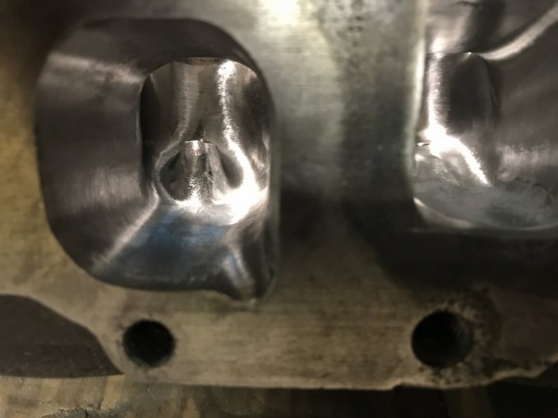

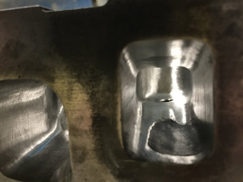

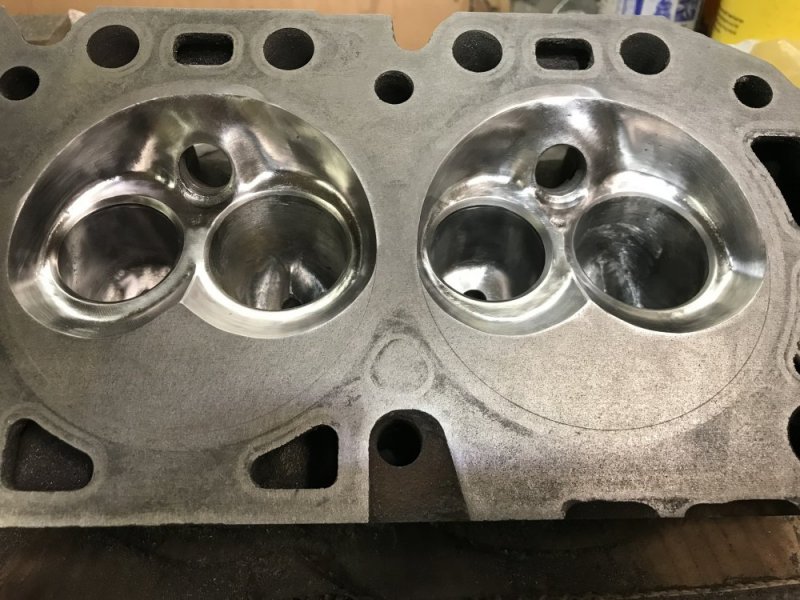

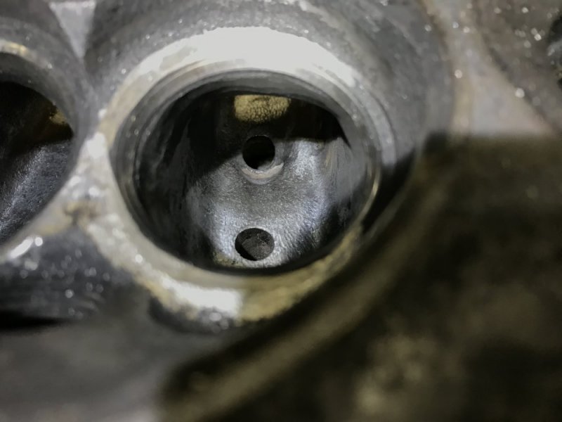

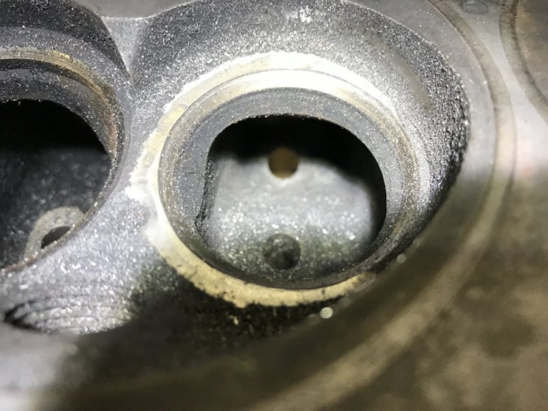

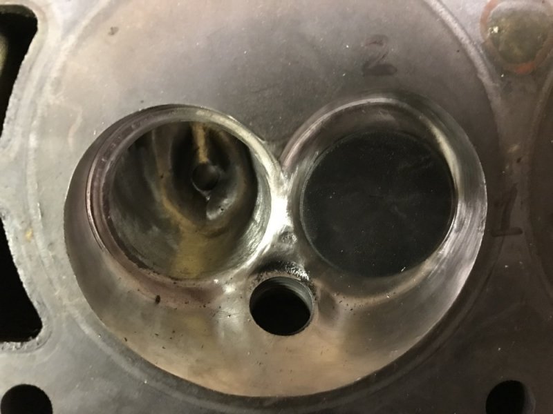

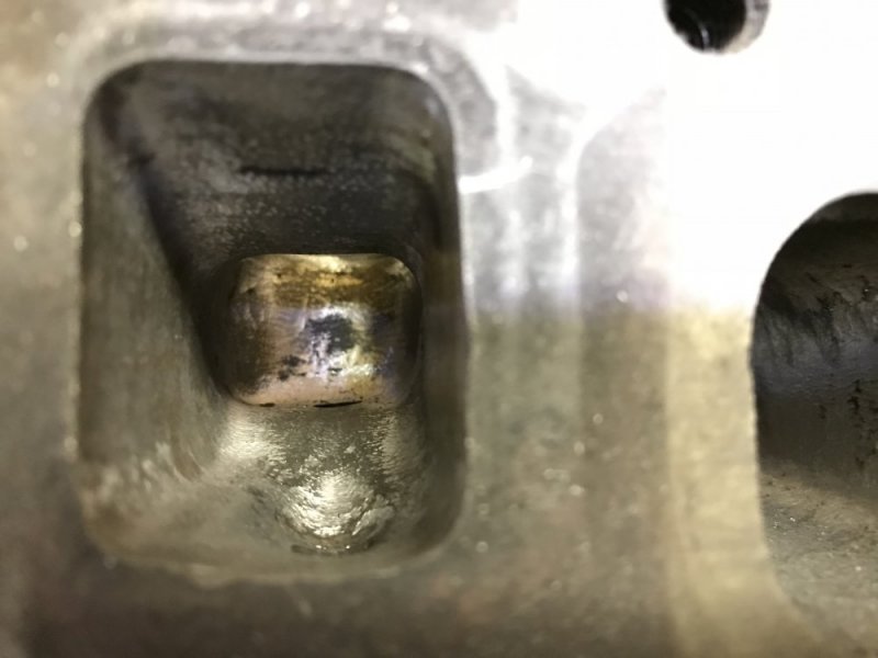

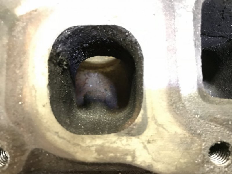

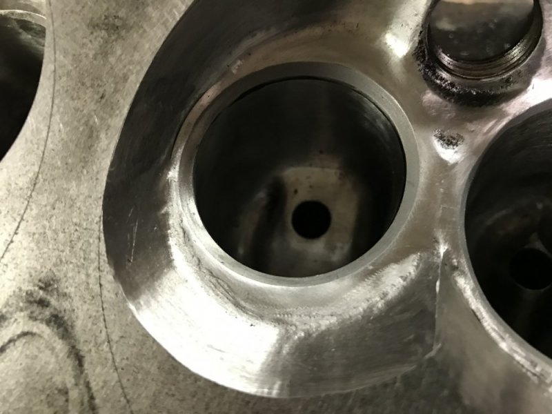

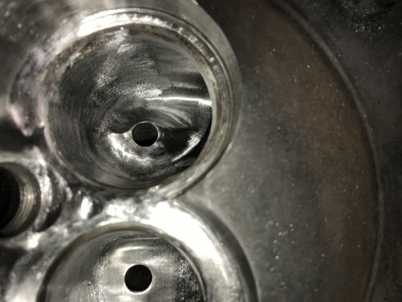

After some sanding and polishing. Note that I put some epoxy in the exhaust ports. I plugged the thermactor ports and applied the epoxy to smooth the port roof. Unfortunately I realized later that the epoxy I used only has a 350 degree temp limit so I have since ground it out so I can try a different product.
95FF2603-A666-47C9-A374-47CF6E957D91.jpeg 4CA8CFA8-7B71-4A43-A51B-1225A87654F3.jpeg E942F682-AA1B-44CA-8F9B-D0EDBD563E3B.jpeg 6B8083AE-507C-40CD-98AE-B6502C300FD5.jpeg FC171DC0-9E71-4C00-AEA3-401FCF20559E.jpeg 085AB6E2-CB6C-4A51-A43F-AEE917A09D6D.jpeg 6DC03F0A-B644-4B15-959A-166F8DD56854.jpeg

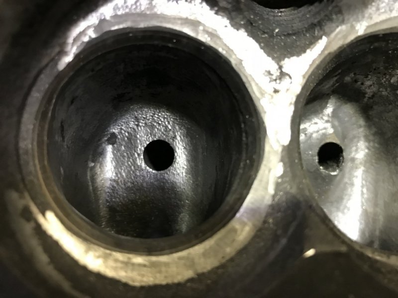

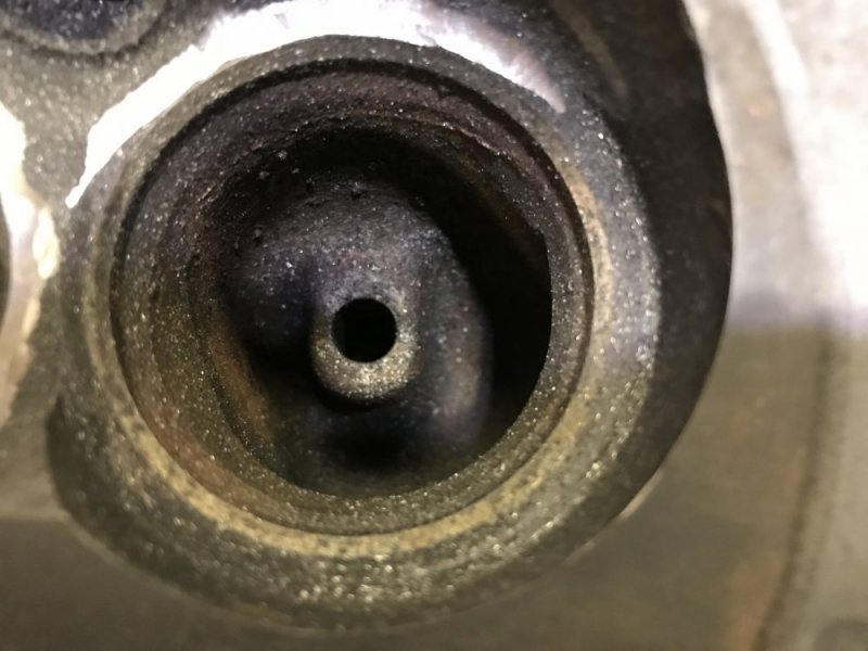

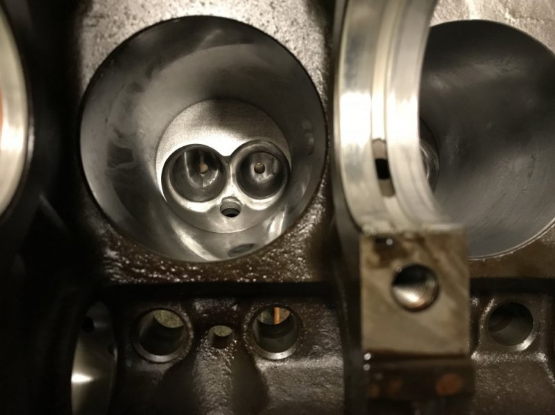

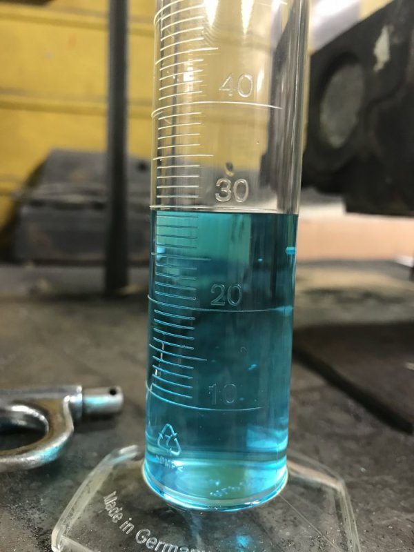

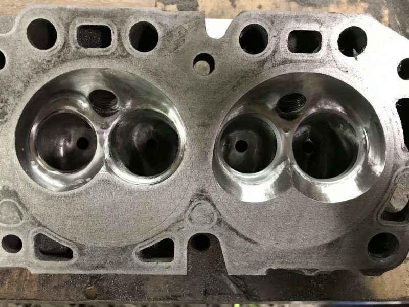

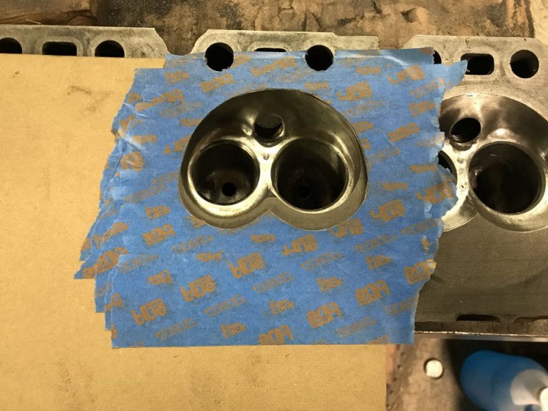

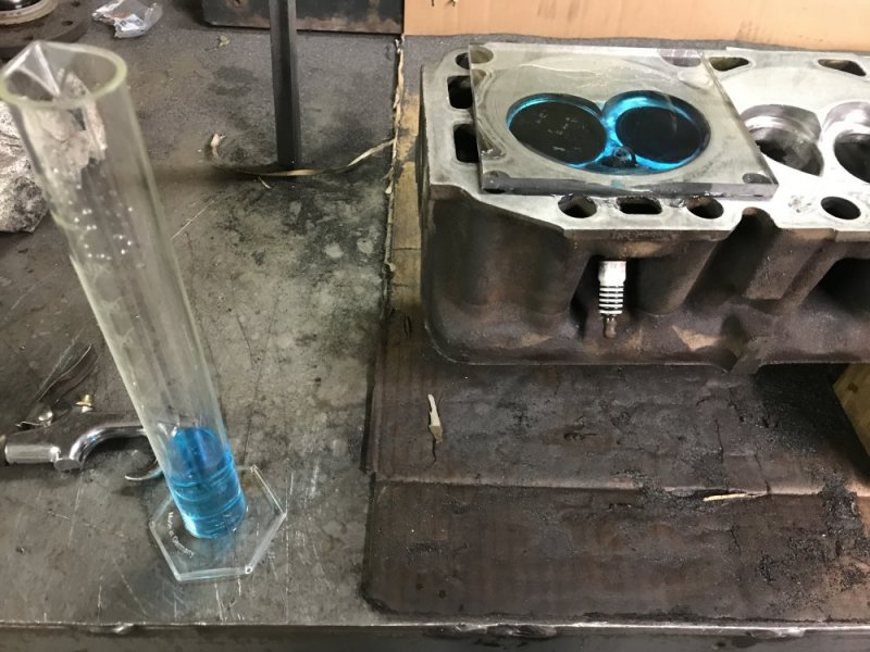

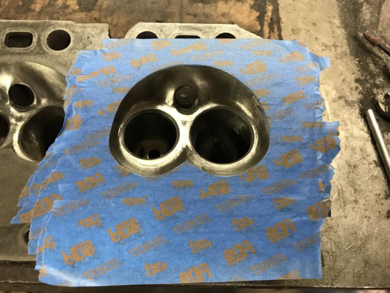

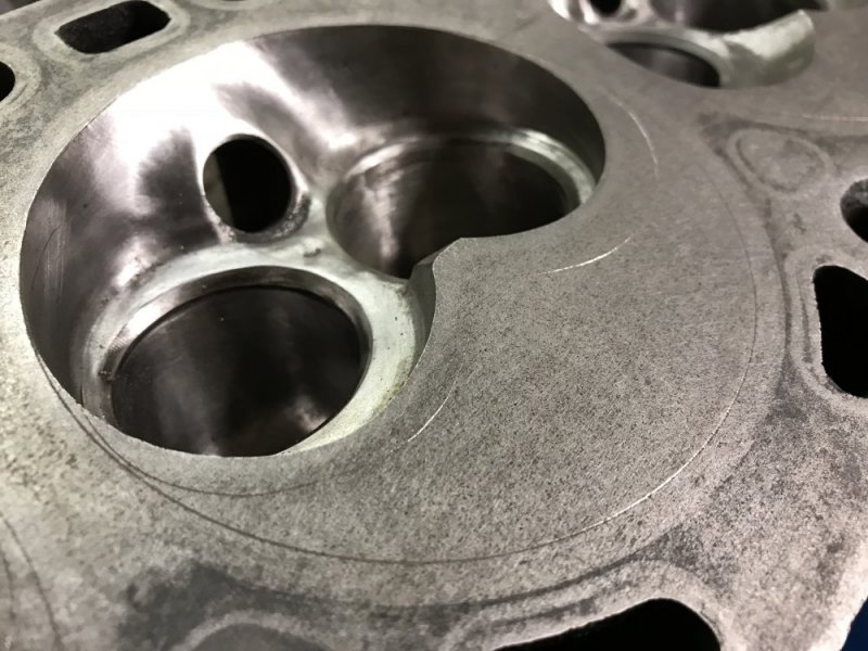

Ok. This is when I decided to go turbo. I needed to adjust the combustion chamber volume to drop compression and also to favor flow instead of fast burn. Before I was at 69cc for the chamber volume and after I was at 75cc. I bolted the head on the bare block and scribed the cylinder outline so I could see how far I could grind the chamber out to. I also took a tip from another builder and ground my intake valve guides down more. E9D68D2D-E2F7-44FA-87EC-90F49B9B91A6.jpeg295F730C-3ACB-41C5-8A95-174AA6B58A15.jpeg7A83F078-ECF3-4E65-B31A-BD36CFBFF5CC.jpegA9ED51A8-69AC-43CC-B50E-EAE90F9BAA8E.jpeg3B99C53A-477E-42A3-8CCC-6E27A5EC1BD4.jpeg
Before on the left, after on the right. A lot of metal removed!
96D910F5-76FE-458D-9637-2C8E54092CB5.jpegE92244AF-44A1-462B-A3C8-AB8F5E09721B.jpegD63BA04F-802C-4104-B6BB-0C1F6FDD1B48.jpeg

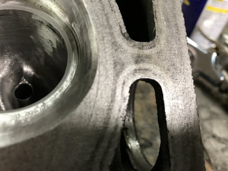

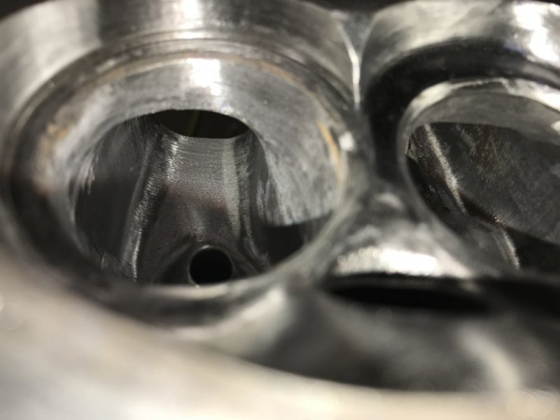

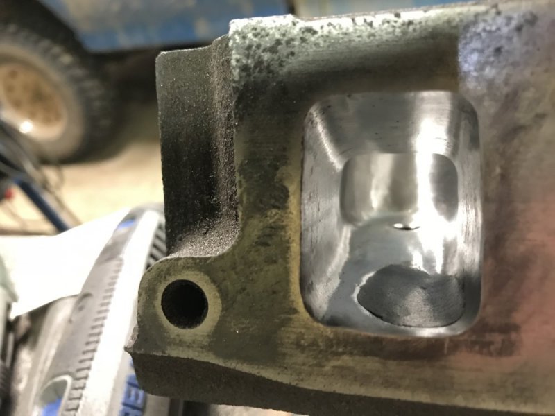

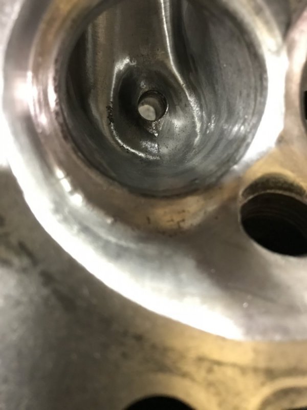

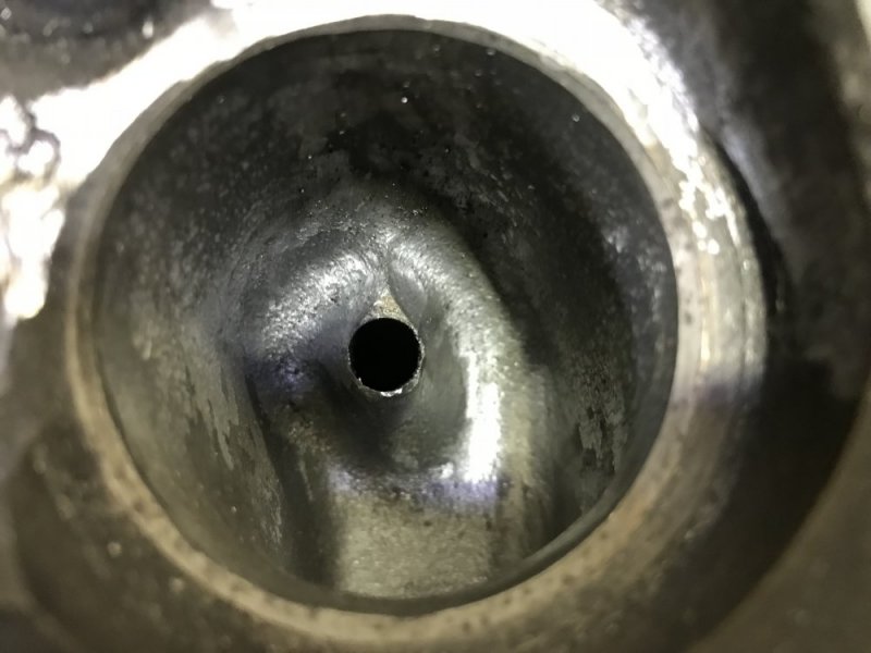

Here’s the valve guide before and after:
4FD27916-22AA-4A4A-90D1-D71865F07A65.jpeg 1BAF27BA-2E39-43B0-BEB7-A44199B93B4B.jpeg C7676A2C-6B50-4EC0-87BE-E50C4E651A49.jpeg EE121405-8BAA-4B9D-937E-BD7A8EAC3032.jpeg

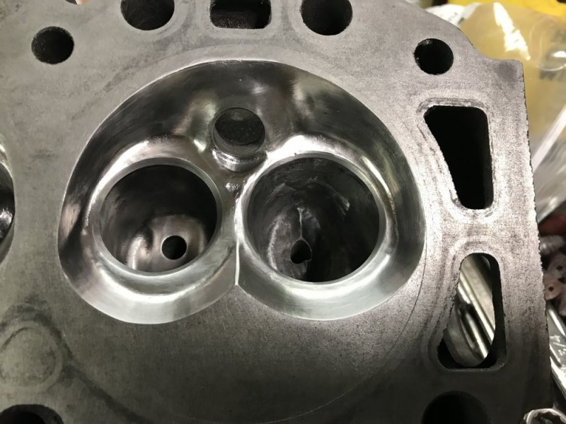

Once ai had the chamber how I wanted it, I made a template out of masking tape and cardboard and transferred the outline to the other chambers.
99F3D09A-6DDB-4202-98BB-4E00AEB2EE03.jpeg EE965E50-1A12-47D6-B564-41C5272BB150.jpeg 8B48EC33-E7A7-43E5-967D-41DCE42DA874.jpeg

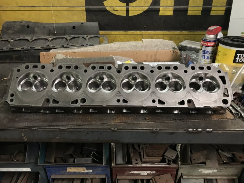

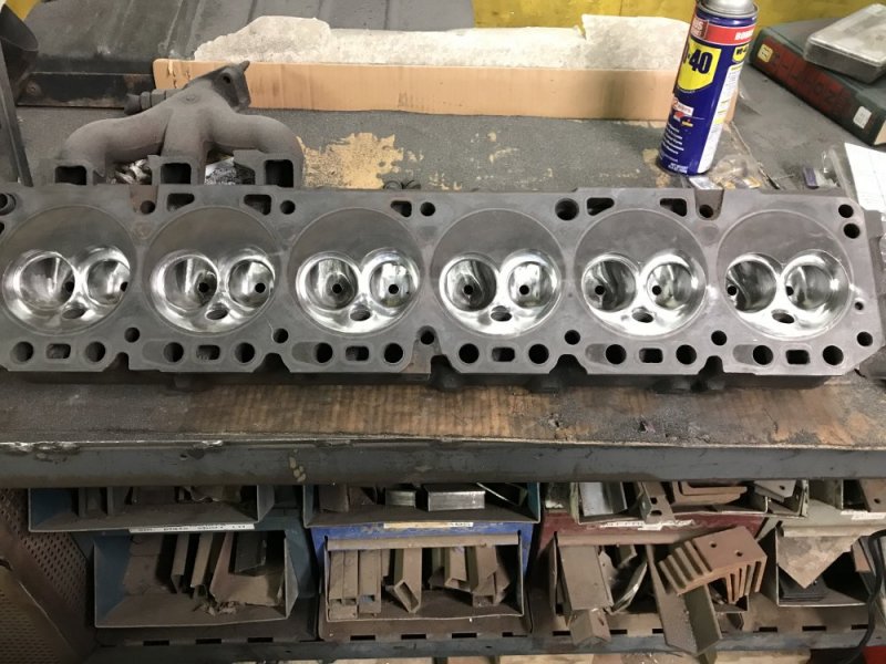

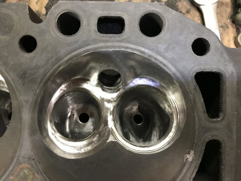

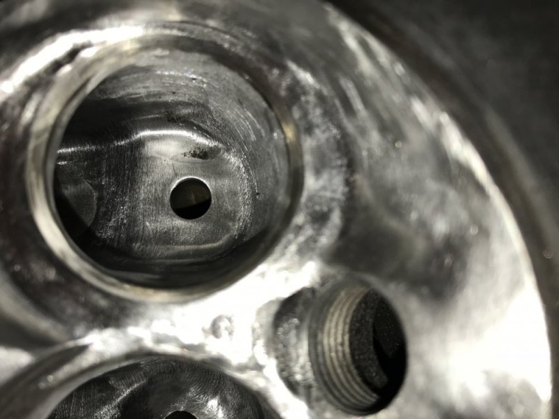

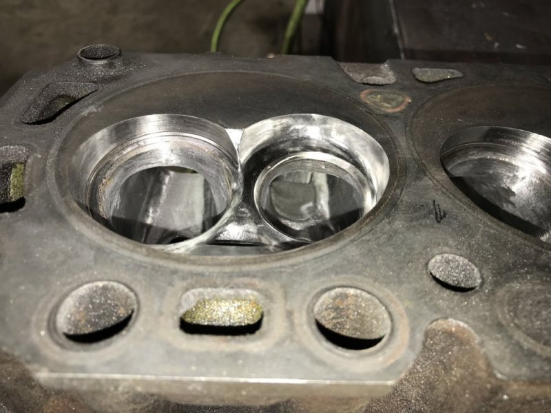

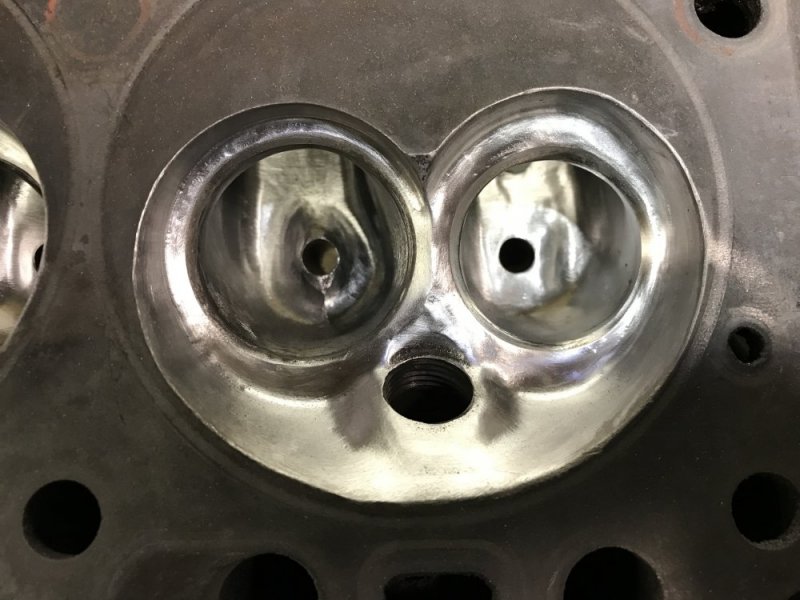

Here’s where I am now. All chambers are ground, sanded and polished. Next step is to buy oversize valves and have the valve job done.
E374174C-C4A1-4515-A796-CF5E5754F4BD.jpeg 31E11E65-E8B0-46E9-9D3B-1A694579ABF6.jpeg A9756B34-EE5D-4C87-9FCF-316285BDB10A.jpeg

Looking good. Have you done the math on old vs new compression ratio? That is a lot of meat gone- haha.

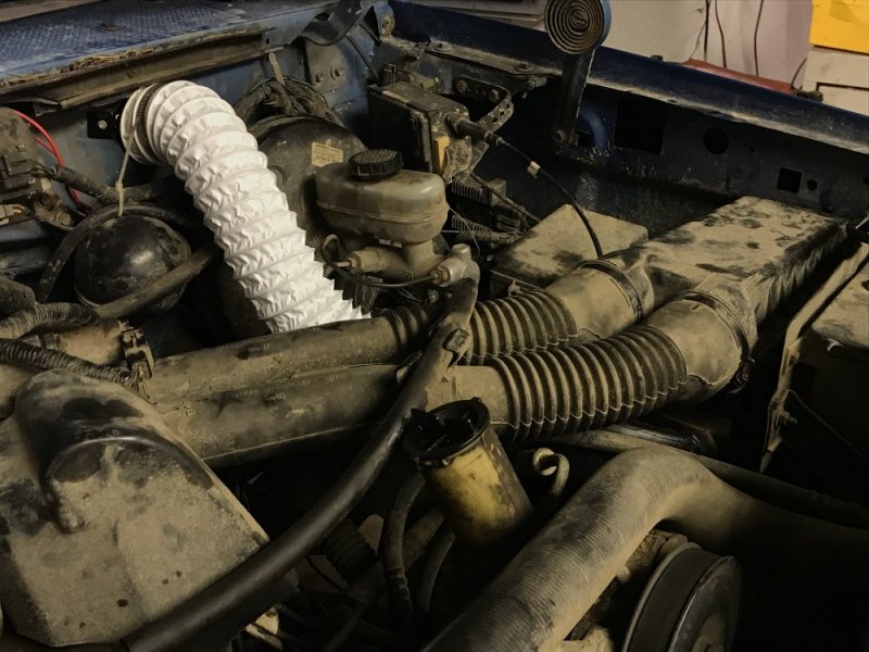

Now while you are at it, get an intake snorkel so it isn’t suck water or dirt when you play. Turbos make up a lot for longer intakes.

don't know much about porting but I'm wondering about the edge of the valve guide hole, wouldn't it be better to have a flat lip around it so no sharp edges could wear/break off?

I have done the math. With the stock pistons I have gone from 8.8:1 to 8.33:1. If I put in the HD pistons that are available for it then I’ll be at 8.03:1, which should be right about where I want to be.

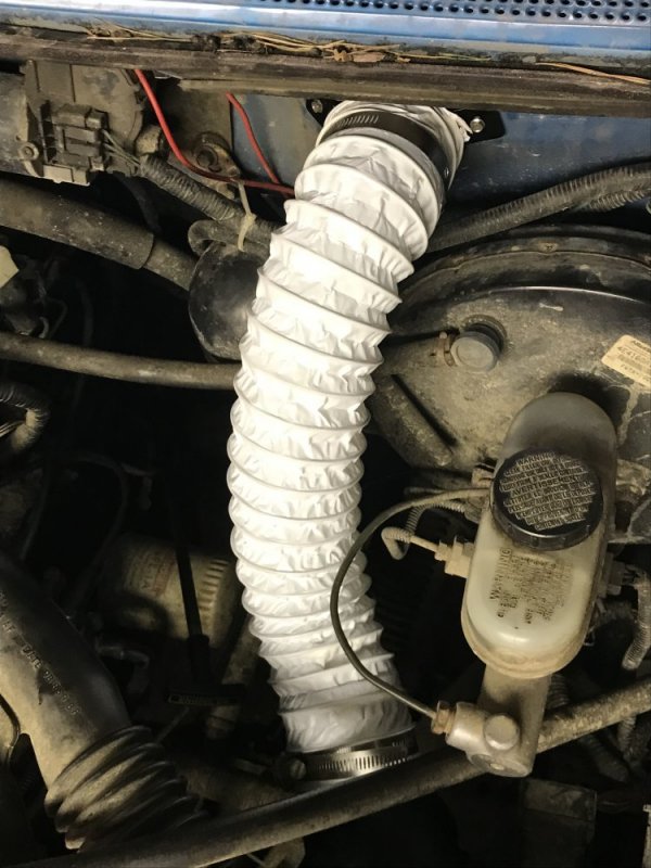

After that last excursion I made a new intake that draws air from the cowl. It will work well for me while I am using the truck as-is, but it won’t be big enough for turbo use. Plus I think the turbo will be on the passenger side so I’ll have a whole new intake situation to figure out.
F94643F6-6194-495D-B873-89AC95A0EDF4.jpeg 36F07EB9-CBCA-453C-9EB3-D6CA8FC6AE30.jpeg CB58E359-73C8-41F1-9F19-0B275722C6BB.jpeg
I have looked at 2 ceramic surface fillers that look promising.
http://www.loctite.sg/sea/content_data/93768_Fix.pdf
https://www.aremco.com/news-item/pyro-putty-2400-high-temp-metal-sealer/
Do you have any experience in this area?
Been wondering where you were, I see you have been busy
Hmmm, not sure. A guy that has a lot more experience than me did his like that, so I figured if it was good enough for him then it was good for me.

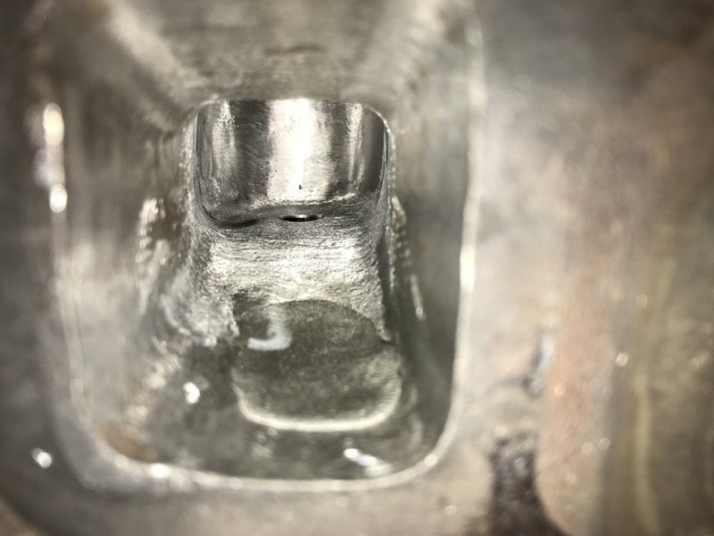

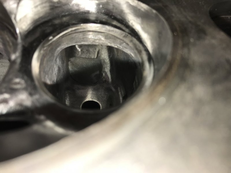

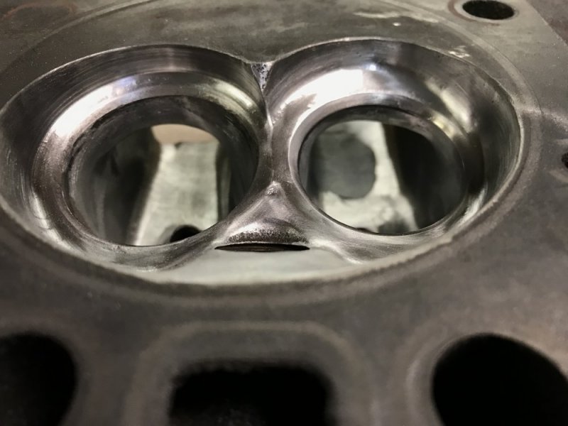

When I want to plug ther AIR ports, I go to the parts store and buy the proper plugs for them.

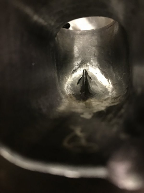

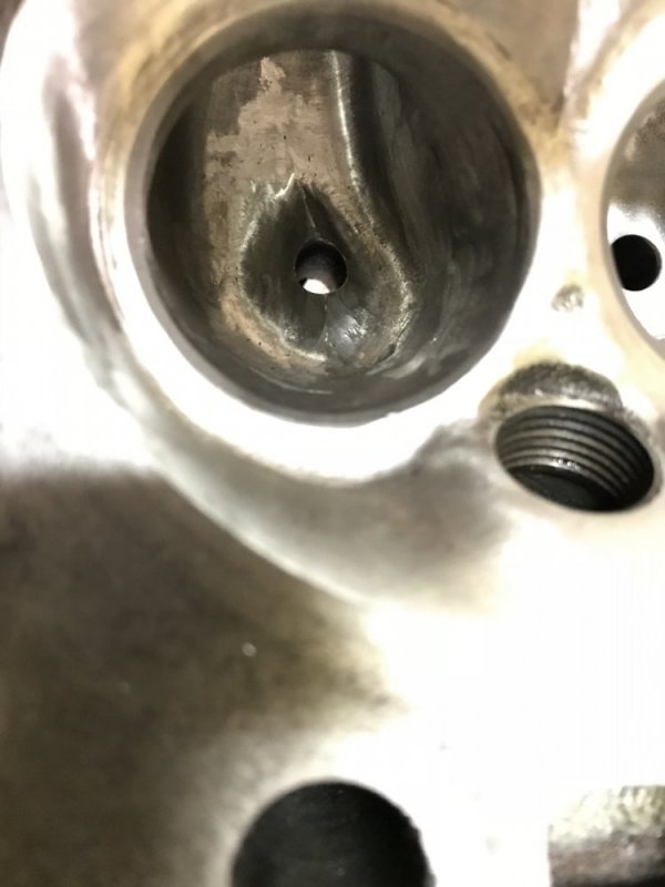

I have them plugged, but I am still left with a port roof that isn’t the contour that I want. In this pic, I have a plug installed and you can see how uneven the port roof is. Note that the head is upside down so the roof is actually on the bottom right now. 72E2F7D1-68D3-4547-A89D-F76964D36CEA.jpeg
This pic shows the contouring I did with epoxy. This is more like what I want the port roof to look like. CDF3ED1A-1520-4DE4-A834-8510EA06296F.jpeg
