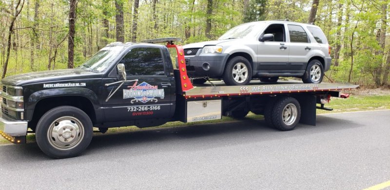

I have a 1994 Chevy C3500HD 6.5 turbo 5 speed roll back tow truck with about 130,000 miles on it.
My question is why would it all the sudden start to blow some black smoke while shifting especially with a load on it
will also do it sitting still if i stomp on fuel pedal. Seems to have also lost a little bit of power taking off also up a incline. You can hear the turbo spool up while shifting only smokes while shifting and when you stomp pedal while sitting still. Drives fine on the highway and while cruising down the road .
