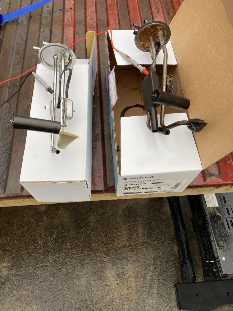

I am having trouble finding a replacement part for a Water in Fuel(WIF) sensor which attaches to the sending unit. Does anyone have a solution? If I cannot find one, I will have to use the old WIF sensor and and attach it to the new sending unit. The old WIF sensor might not be working but I need something to close the connection to the wiring.

Welcome to the forum. for the WIF sensor, it should be located on the bottom of the FFM housing located at the rear of the intake on the engine. not sure if the sensor is available seperatly or you would have to get the complete housing. it has a fuel heater in there also. others will chime in soon with more info than I have. I eliminated my FFM and went with a firewall mounted filter that has a clear bowl. never installed a WIF sensor in it, just left the harness unplugged for it.

Welcome and sorry new guy- JWRP those haven’t been available for a few years now.
@dbrannon79 GM eliminated the wif inside the tank. They were quite troublesome and labor intensive under warranty.
He does not have an ffm. He has a huge cube filter that has tremendous air intrusion issues also. Thats why when gm moved the wif, they eliminated that filter set up also.
Napa has a good selection of the connectors to plug in a new set leading to wherever you want to mount a new wif.

The combo unit @dbrannon79 shows is good, however is 10 microns. You need to go 5 microns for this rig. So if you can get a different filter to that spec, or use a secondary filter afterwards- then ok.
If a person has a dead donor truck, yea things move over easily. Otherwise buy a separate unit and just run some new lines.
No way would I pay for a brand new gm ffm- just my opinion.
Well, the newer diesel screw on filter set up yes. 5 micron minimum- but price depending. And check replacement filter cost and availability.

I had ran that 10 micron filter for a while and then later replaced it with a 2 micron filter. I'm not sure what the thread pitch is on the bowl though. I can't seem to find a "universal" WIF sensor on amazon to screw into that port. maybe if someone knows which one will work, it might be a decent alternative for others to use.
the only caviot with my setup is that I live in Texas where the winters here don't get cold enough to need that fuel heater. for others further north, that might not be a good option!

Thanks for your help. I spent many hours looking for a replacement WIF Sensor. I decided to just put the old sensors in for now. I’ll probably look at inline WIF systems.
