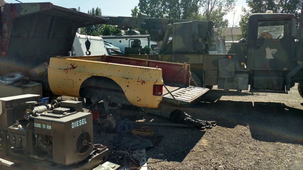

So I'm more than a little pissed off at my landlord/one of the roommates. After doing all that work to shorten the drivetrain/bed so it fits into the garage (only reason I cut it), he decided to buy a new car and is determined to find a way to park it in the garage, where the pickup currently sits. The reason the truck gets parked in the garage is because of everyones work schedule, I'm the last to leave every morning and the first one back (usually). Yea, I've been ****ing livid at him since he mentioned that. Losing the garage space isn't the big deal, waiting until after that amount of work (5000-8000 dollars if a shop did it) to make that kind of decision, that's the damn problem.
The bed is already traded off in exchange for some bucket seats from a mid 2000's yukon so I'll have to decide between a flatbed or searching for a regular side longbed. The frame section/rear bumper/hitch is just sitting in my steel scrap pile right now but I'm very seriously considering taking the truck back out to full length again. Haven't cut the driveshaft yet or bought a suburban fuel tank either so other than the bed all the parts are still here. At least extending the truck doesn't require any rivet removal, just some welding and reinforcements.
