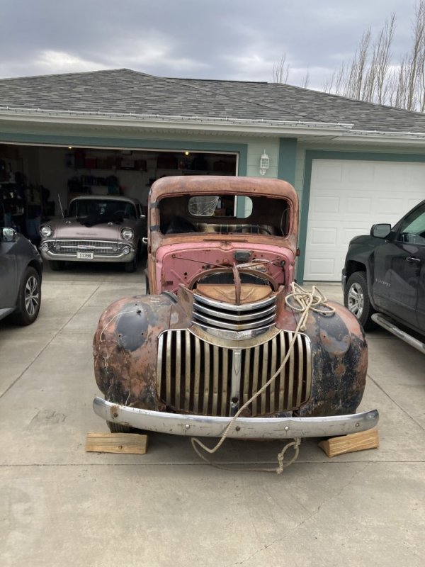

New to forum. Building a 1941 Chevrolet AL ( 3/4T) pickup. Am putting a 1996 GMC Sierra 1500 4x4 chassis under it. Have an LS1 5.7l engine for it. Have not decided on what transmission to use. Any suggestions? Am converting the rear brakes to disc brakes so it will have 4-wheel disc brakes. Just started disassembling the '41.
A few weeks ago before I got it in the garage so I could take it apart. Had to find a place to store the '57 Chevy first.
